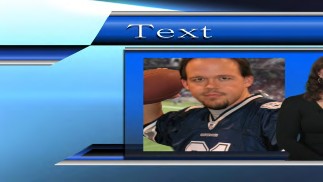

Viz Vectar can also employ special transition effects called Animation Stores. These powerful effects normally include an embedded full color animated overlay, along with sounds for transitioning in and out (sounds are optional). The audio level for Effects is controlled in the Audio Mixer tab below the Switcher.
These special Animation Store transitions are loaded into the Transition Palette in the same way as their less colorful cousins, using the Browse feature. A number of Animation Store transitions are custom animation content you have to access to or create using art software.

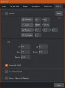

Position and Crop
images/download/thumbnails/68851813/Image_187.jpg
The Position control group includes Position, Zoom, Rotation, and Priority. Position settings can be toggled on and off together using the switch provided in the group header. Click and drag on the Position button (diamond) to relocate the DSK layer vertically or horizontally within the frame. Drag left or right on either of the two nearby numeric controls to adjust a single axis only. Dragging the cursor on the Zoom button (magnifying glass) affects the apparent size of the overlay.
Again, if you drag just one of the associated numeric gadgets you can adjust just one dimension of the corresponding DSK layer – width or height. In similar fashion, drag the pointer over the Rotation button with the left mouse button depressed to turn the overlay source on three axes as follows:
  • Drag left/right to rotate the source about the Y (vertical) axis.
  • Drag up/down to rotate about the X (horizontal) axis.
  • Drag while holding ALT down to rotate about the Z axis.
  • Drag on a single numeric slider, or hold down CTRL to constrain rotation to one axis.
Tip: If you click a numeric field (or right-click it), you can type a value into the gadget using the keyboard; press ENTER to complete the editing action, or ESC to cancel it).
The Crop DSK/KEY controls in this group are similar to those found in the Input tab, as discussed in Input Configuration. However, these settings are applied to the DSK/KEY layer, without any impact on the source itself as it may be displayed elsewhere in the Switcher.
Info: DSK and KEY layers automatically appear on the Preview and (M/E Preview) monitors when the Position panel is open (regardless of layer display options). This allows you to modify a layer’s position without the result being inadvertently shown on output.

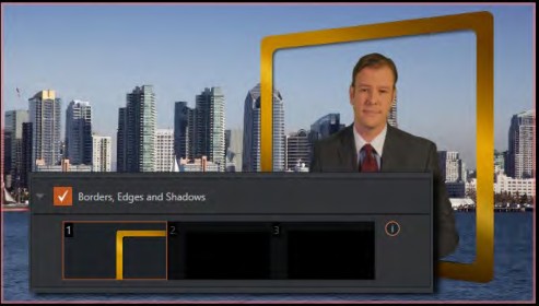

Borders, Edges and Shadows
images/download/attachments/68851813/Image_192.jpg
The Borders, Edges and Shadows group also provides each DSK, KEY and M/E layer with three quick access Border preset slots.
Tip: Since these are per-layer Position effects and can be controlled – even animated – by Comps, you can use the Borders feature to create custom multi-box compositions in M/Es.

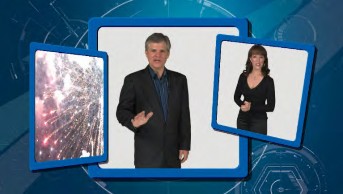

These powerful effects can include full color overlays, backgrounds, matte layers for keyhole effects, and shadows. You can freely scale, position and rotate various Switcher sources, add custom borders, overlays, shadows, and so-on, over custom backgrounds. In addition to hundreds of supplied borders, you can easily create elaborate custom effects using Photoshop®. You need merely define a Photoshop™ format file with three (rasterized) layers. The uppermost layer contains foreground elements (such as a bezel). The next layer is treated as a mask based on opacity and defines the part of the source image that appear in the result. The bottom layer supplies a background to appear behind transparent parts of the source (as, for example, when LiveMatte is applied to a source).
images/download/attachments/68851813/Image_193.jpg
A template PSD file is supplied to assist you to do this. The multi-layer Photoshop™ file is in the Borders folder at C:\ProgramData\vizrt\Effects\Borders.
Tip: Since the opacity of the mask layer can vary between fully opaque and fully transparent, you can easily prepare soft-edged effects such as vignettes. Also, as foreground and background layers can optionally be empty, a simple opaque shape in the mask layer can serve a variety of imaginative purposes.

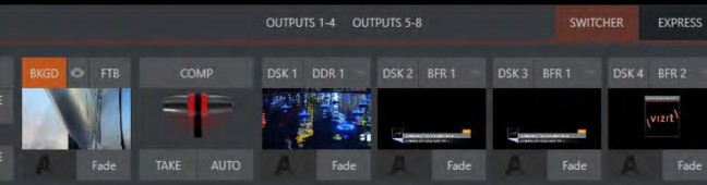

Let’s discuss the FTB feature next. The acronym stands for Fade to Black. FTB offers a convenient method of doing what its name implies – fading Program output completely to black. It might help to think of FTB as a final video layer added above all others before Program output, completely obscuring everything below it.
As a memory aid, the FTB button pulses during operation. FTB’s fade duration is drawn from the BKGD transition setting.
Note: Hold down SHIFT while pressing the FTB button on a control surface to initiate an FTB operation. Hiding or displaying FTB triggers both Autoplay and Audio Follow Video when enabled for Media Players. It also fades Master Audio to mute when displayed, and back up again when hidden.
Take and Auto
images/download/thumbnails/68851813/Image_198.png
Clicking the Background layer’s Take button (keyboard shortcut ENTER) performs a straight cut for all video layers that are currently delegated. Likewise, if you press Auto (or the keyboard SPACEBAR), the transitions assigned to all delegated video layers are performed.
Tip: You can halt an Auto operation partway by clicking the button a second time during the transition. The operation is completed the next time you click the button.
T-bar
The T-bar mimics the similar control on a traditional video switcher and allows you to manually transition between selected video layers. To use the T-bar, pull it downward by dragging it with the mouse pointer. Drag it all the way to the bottom and release to complete a transition; the T-bar then pops back to the top.
Tip: Naturally, when the T-bar is dragged part way, a partial transition occurs. With certain transitions this can be useful for split screen effects.
