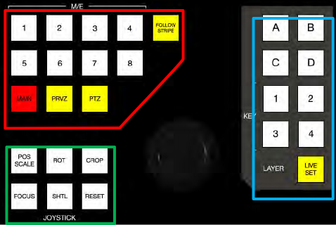

images/download/attachments/68852014/Image_434.png
  • The specific target of Joystick operations at any moment is determined by a set of Joystick delegate buttons, outlined in red above.
  • As appropriate, this selection is further refined by buttons in the Layer group at right, outlined in blue above.
  • Finally, the nature of the operation performed on the target is determined by a set of Control Mode buttons at lower left, outlined in green above.
Let’s consider the primary delegates first.
Delegates
Follow Preview
Probably the most useful joystick delegate mode is Follow Preview. You probably won't be surprised to learn that, when enabled (as is the default in new sessions) the joystick assignment tracks your Main > Preview (PREV) row selection.
Since the Live Desktop normally displays a large Preview monitor, this makes setting up exactly the shot you want for the upcoming source queued on Preview the proverbial no-brainer. Or, to quickly modify the framing of a bunch of PTZ cameras, or a series of M/Es, just select them one after another on the PREV row and adjust to taste.
Tip: To open the Input Configuration panel for the source currently selected on the Preview row to adjust its settings, tap the * (asterisk) key in the keyboard numberpad.
Of course the joystick has several other delegate modes, discussed next, but the default Follow Preview mode is very useful, and can be easily restored from any other mode by pressing the PTZ and RESET buttons together.
FOLLOW STRIPE
Pressing this Joystick delegate button restricts the behavior of the Joystick in a manner many are used to from using traditional control surfaces. That is to say, Joystick operations are always directed to the video bus(ses) assigned to the same stripe. As mentioned though, Viz Vectar surfaces offer greater versatility and control options. It’s possible to quickly redirect control to any suitable target without interrupting Switcher operations on neighboring stripes.
M/E 1 – M/E 8
These buttons provide a quick and convenient way to delegate Joystick operations to one or more selected M/Es (the number of M/Es varies by Viz Vectar model).
MAIN
Press MAIN to direct delegate Joystick operations to the Main Switcher.
PRVZ
PREVIZ controls are currently not in use.
PTZ
Source Select
Depending on the Viz Vectar model and feature set, PTZ (pan-tilt-zoom) style joystick operations are not limited to real PTZ cameras. Static cameras, Media Players, and Buffers are among the different source types that may benefit from virtual PTZ functionality. And of course M/Es have similar capabilities courtesy of COMP and Positioner features.
For this reason, you can delegate any source that is qualified for Joystick control on your system as follows: Hold down the PTZ button and press the desired KEY row button at left in the same stripe as the Joystick.
Press an M/E button (1-8), MAIN, or FOLLOW STRIPE to reset the Joystick to the corresponding operating mode.
Presets
In addition to manually controlling the PTZ camera with the Joystick, of course, you often want to store and recall PTZ presets.
  • To store a new preset for the currently delegated camera, or to update an existing preset, hold down the PTZ button and press a button numbered from 1-16 in the A/C row at left in the same stripe.
  • To recall a preset, hold down the PTZ button and press a button numbered from 1-16 in the B/D row at left in the same stripe.
LAYER Delegates
images/download/thumbnails/68852014/Image_436.jpg
As mentioned above, some Joystick delegate modes let you further refine the target for your manipulations. For example, when your primary delegate is MAIN, joystick operations can be applied to the DSK 1, DSK 2, DSK 3 or DSK 4 video layers. The LAYER delegate group determines which one is affected.
Specifically, the KEY buttons labeled 1-4 direct joystick control to DSK 1-4 when MAIN is selected as the primary delegate, or KEY 1-4 for an M/E. Similarly, when an M/E with a compositing effect selected as the Background effect is delegated, the A, B, C and D buttons allow you to target the individual Positioners for the main M/E layers (A-D).
