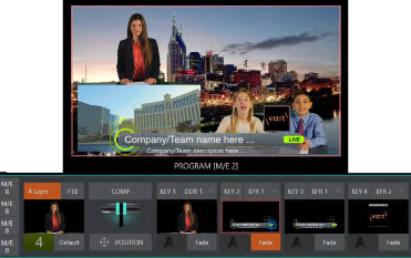

Effect Mode
images/download/thumbnails/68851895/Image_293.jpg
Even casual scrutiny reveals some (outwardly) subtle differences in the M/E control configuration when a LiveSet is loaded as the Background effect selection, as follows:
  • The Take/Auto buttons located beneath the T-bar and Transition icon are replaced by a Position button.
  • As required, as many as four input rows (A, B, C, and D) may be shown in Effect mode.
  • Positioner controls may appear for these input layers.
Let’s consider the reasons behind these changes in the interface. An M/E in Effect mode allows preparation of a composite of two or more video sources, whether for direct output, or as a source for the main Switcher, or as an input for other downstream channels (including other M/Es).
Even in Mix mode, an M/E provides access to effects – including Position and transition effects and animating KEY layers via the Comps feature. In Effect mode, however, an M/E asserts its real-time compositing and effects prowess more aggressively.
