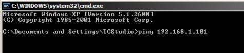

  2. Type ping followed by a space and the target IP number, as in the image below:

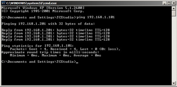

    Successful Ping Example:
    images/download/attachments/68851971/Image_372.jpg

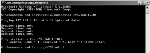

    Ping Failure Example (indicating a network problem):
    images/download/attachments/68851971/Image_371.jpg
