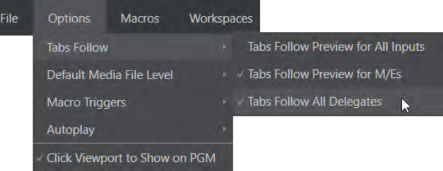

A number of very useful interface and workflow options are presented in the Options menu.
  • Tabs Follow
    • Tabs Follow Preview Row for All Inputs: Displays the tabbed pane for a Preview row source automatically on selection changes (for M/E selections, the M/E pane must be maximized to see the M/E tab update).
    • Tabs Follow Preview for M/Es: Updates the M/E pane selection only (when you select an M/E as source on Preview) when checked.
    • Tabs Follow All Delegates: Updates the Desktop in sync with control surface delegate changes.
      images/download/attachments/68851770/Image_117.png
Tip: Control surface delegate operations can sometimes result in a tabbed module that you want to view being obscured when certain options are enabled. When this happens, press the control surface Delegate button again to re-display the tabbed pane you are interest in.
