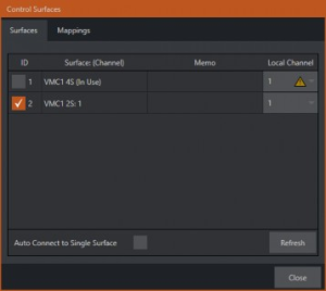

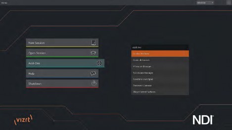

To allow you to manage these control connections, the Control Surfaces configuration utility is included in the Launch panel’s Add-Ons menu.
  1. The utility automatically identifies and lists qualified control surfaces it finds on the network.
  2. Each surface discovered is listed in a numbered row. The ID number for the row is not permanently associated with a particular surface, and may change as surfaces are added to or removed from the network. The ID number serves a very useful purpose. If you look at the top-left LCD display panel of an un-paired control surface when this utility is open, its ID number is temporarily shown. This makes it easy to match an entry in the panel with a specific physical surface.
  3. Once you identify the surface you want to use, check it in the list to claim it for the local system (the steps in Setting the Channel complete the communication connection to the surface).
  4. You can also enter a brief description (Master Control CS) into the Memo field, for later reference.

Finally, notice that a Local Channel menu is provided for each surface: More accurately, for each echelon, or two stripe pair on the surface (see Control Schema). Let’s discuss this detail a bit further.

The Control Surface utility identifies the channel each control surface is on by a number from 1-8 after the colon in the Surface: (Channel) column. Normally, you can set the Local Channel to match this value (a bang is shown if the channel the surface is set to does not match the Local Channel).
