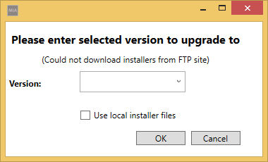

Upgrading
An automatic upgrade with the Viz Mosart Installation Administrator allows the user to seamlessly upgrade an existing Viz Mosart installation. The existing installation must have been installed with the installation assistant in order for the fully automatic upgrade to work.
The automatic upgrade will display all newer versions found in C:\Mosart\Installers.
Select the version you want to install, and click OK.
The following actions will take place:
Some critical user-data will be backed up - see Backup Files
Services will be stopped - see Stop Services
Uninstall all found Viz Mosart Applications
Mosart Applications will be installed (replacing uninstalled applications) - see Install Mosart
Services will be started - see Start Services
