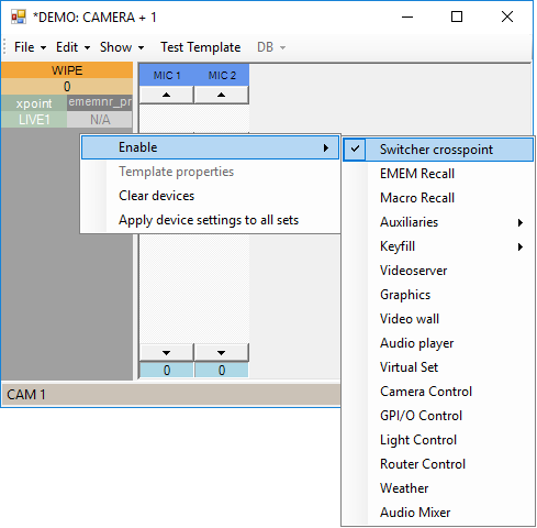

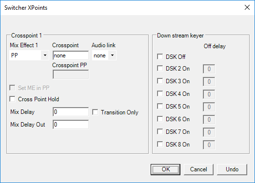

Video Switcher Crosspoint
The video switcher crosspoint enables switching on the video switcher. The A or B bus assignment of the mixer effect (PP/MEx) is automatically handled by the automation.
Guidelines for Video Switcher Crosspoint Configuration
Item |
Description |
Mix Effect |
Selects which Mix Effect (ME) bank on your vision mixer that you are currently handling. |
Crosspoint |
Crosspoint on the video switcher. Default value: none Newsroom tag available. The source is not selected until you click OK and a drop-down menu, listing of available x-points, appears. |
Audio link |
Default value: none |
Crosspoint PP |
If another Mix Effect (ME) than PP is selected, then you can select a crosspoint for program by writing the crosspoint name in the field. |
Set ME in PP |
If another Mix Effect (ME) than PP is selected, check this box to make that ME the crosspoint for PP. (Checking this box disables XPOINT PP). |
Cross Point Hold |
Keeps the crosspoint on the selected Mix Effect. |
Mix Delay |
Offset, in frames, of when to perform the transition. |
Mix Delay Out |
Delay, in frames, of when to perform the next transition. |
Transition Only |
Only delay the switcher transition (sub items will perform). |
DSK Off |
Turns off the Downstream Keyer (DSK) on the video switcher when the template is active in program. |
DSK 2 On, ..., |
Downstream Keyer (DSK) 2-8 on. Turns on the DSK 2-8 (PP key 2-8) on the video switcher when the template is active in program. |
Off delay |
Delay in frames to set the DSK 2-8 off. |

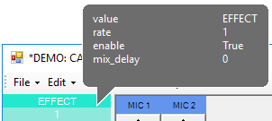

Video Switcher Transition
The transition device is only available when video Switcher crosspoint is enabled.
To Define Video Switcher Transitions
Click on the entry to cycle through the transition types; MIX, WIPE and EFFECT.
Click directly on the value.
Enter
The default duration for the Mix/Wipe transition, or
The effect name for the Effect transition.
The transition is performed with the auto transition functionality in the video switcher.
Usage and Tips
To do a cut, use a MIX transition with 0 frames duration.
To add a mix delay, enter a value in frames in the same property window.
Adding a mix delay delays the start of the transition, compared to other device commands, when the template goes On Air. -
To disable the transition, right-click over the device and select Disable.

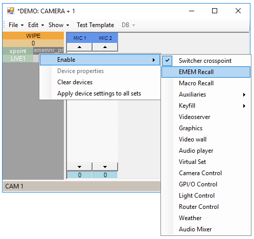

Video Switcher Register/Timeline Recall (EMEM Recall) will recall a register and/or timeline in the video switcher.
To Open the Video Switcher Register/Timeline Recall
Open Template Editor.
Right-click over ememnr_pr
Select Enable>EMEM Recall
Enter or select required values

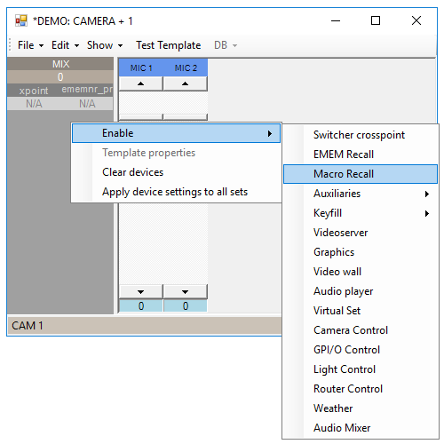

To Open a Macro Recall
Navigate to Enable > Macro Recall
Enter or select required values.

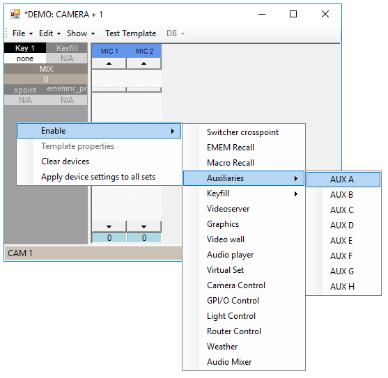

Video Switcher Key Bus Delegation (Keyfill)
Video switcher key bus delegation enables routing of internal video switcher signals to the keyers on the different mixer effects on the switcher.

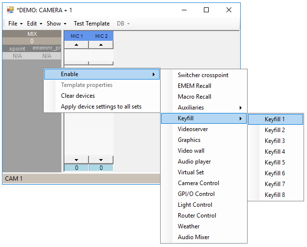

To Enable Keyfill by Bus Delegation
Navigate to Enable > Keyfill > [Keyfill index]

Video Switcher Auxiliary Bus Delegation
Auxiliary bus delegation enables routing of internal video switcher signals to the auxiliary outputs of your video switcher.
Type or select relevant values.

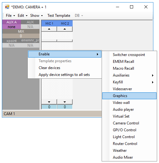

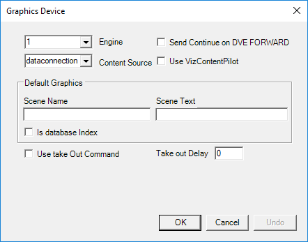

Graphics
The Graphics device enables recall of graphic elements.
Graphic elements are cued (loaded) in Preview and played (started) when taken to Program.
Guidelines for Graphics Configuration
Engine |
Selects the engine to operate on when using this template based on your configuration. |
Content Source |
Send Continue on DVE FORWARD |
If checked, a continue command is sent together with a DVE Forward command. |
Use VizContentPilot |
Enable to run this element through a Viz Pilot client. This allows for OnLiveUpdate events in Viz Pilot data elements. |
Scene Name |
The default scene name is used if not overridden by the NCS. Newsroom tag available. |
Scene Text |
The default scene text will be used if not overridden by the NCS. Newsroom tag available. |
Is database Index |
Use take Out Command |
If checked, a take-out command is sent when the template status changes from On Air to Off Air. |
Take Out Delay |
Delay of sending takeout command after template status changes from On Air to Off Air. |

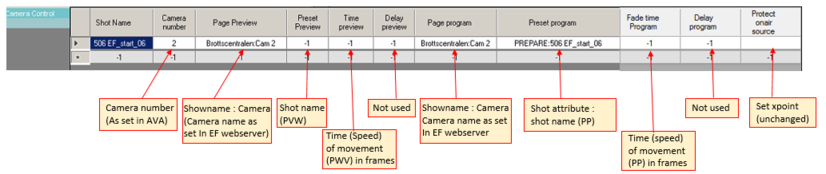

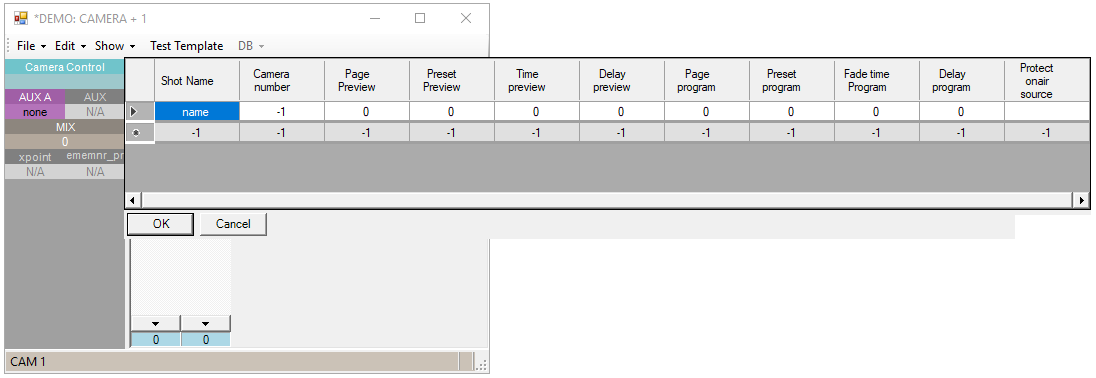

Robotic Camera Control
The camera control device allows for recalling camera shots (and pre-programmed moves) when the template is cued in preview or aired in program. The device editor supports salvo recalls of shots by adding multiple lines for each shot recall.
The Standard Robotic Camera Control Properties are described below, as well as exceptions for specific camera types:
Guidelines for Standard Robotic Camera Control Configuration
Shot Name |
Name of the shot. |
Camera number |
Page Preview |
For recalling a shot/move when the template is cued in Preview. |
Preset Preview |
Time preview |
Time to shot’s position in Preview. |
Delay preview |
Delay of the move when cued in Preview (frames). Not recommended for use! Will be deprecated in future versions. |
Page program |
For recalling a shot/move when the template is aired in Program. See Page Preview for an explanation. |
Preset program |
For recalling a shot/move when the template is aired in Program. See Preset Preview for an explanation. |
Fade time Program |
Time to shot’s position in Program. See Time preview. |
Delay program |
Delay of move in Program (frames). Only available for Radamec robotics systems |
Protect onair source |
Protected video switcher cross-point. If the video switcher cross-point is On Air, the shot/move recall will be ignored. This protection may, by configuration for some robots, be confined to Preview and/or Program, and to Cuts and/or Moves. |
Cambotics Properties
Camera Number: Set camera number to 1.
Page Preview/ Page program: Robotic camera number.
Preset Preview/ Preset program: Shot number.
Time preview/ Fade time Program: [Optional] Duration for move in deciseconds (10 deciseconds = 1 second).
Note: All parameters not defined specifically, must be set to -1.

Telemetrics Properties
Page Preview/ Page program: Preset page number to recall.
Preset Preview/ Preset program: Preset number to recall.
Time preview/ Fade time Program: =0 cut, <0 ~ default time to shot, >0 ~ wanted time (seconds).
Vinten 200 Properties
Page Preview/ Page program: Name of the show to recall.
Preset Preview/ Preset program: Name of shot or move to recall.
Time preview: <0 ~ go to end position of a move, = 0 ~ cut to shot, >0 ~ go to start position of a move, or move to a shot (frames).
Fade time Program: For moves, move forward or backward according to Time preview. For shots, = 0 ~ cut to shot, ?0 ~ move to shot (frames).
Electric Friends Robotic Camera
For Preview use:
Page Preview: Show and Robotic camera name separated with a colon (e.g.: ShowName:Cam 1).
Preset Preview [Optional]: Shot name. Shot attributes: prepare, prepareplay and loop. Separated with a colon (e.g.: prepare:ShotName and prepareplay:ShotName).
Time Preview [Optional]: Duration for move in frames. The time is rounded up to the nearest second.
For Program use:
Page Program: Show and Robotic camera name separated with a colon (e.g.: ShowName:Cam 1).
Preset Program [Optional]: Shot name. Shot attributes: prepare, prepareplay and loop. Separated with colon (e.g.: prepare:ShotName and prepareplay:ShotName).
Fade time Program [Optional]: Duration for move in frames.The time is rounded up to the nearest second.

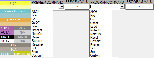

Light Control
Note: The commands to use are driver-dependent and may vary.
Guidelines for Light Control Configuration
Option |
Description |
PREVIEW COMMAND |
Command to use for the light mixer cue to be recalled when template enters preview. Newsroom tag available. |
PREVIEW VALUE |
Light mixer cue to use when template enters preview. Note: Newsroom tag available. |
PROGRAM COMMAND |
Command to use for the light mixer cue to be recalled when a template is taken On Air. Newsroom tag available. |
PROGRAM VALUE |
Light mixer cue to use when a template is aired in program. Newsroom tag available. |
Preview Command and Program Command options are available from the drop-down list:
Command |
Parameter count |
AllOff |
<none> |
Fire |
1 |
Go |
cue number |
GoOff |
cue number |
Load |
cue number |
NoteOff |
numeric note # (Std. MIDI command) |
NoteOn |
Reset |
<none> |
Restore |
<none> |
Resume |
variable |
Set |
4 or 9 |
Stop |
cue number |
Custom |
SysEx bytesSend multiple custom SysEx bytes in the format \xnn where nn is a numeric value (0-255). |
TimedGo |
- (unsupported) |

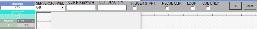

Video Server
Guidelines for Video Server Configuration
Setting |
Description |
SERVERCHANNEL |
Selects which server channel is to be used by this template. |
CLIP HIRESPATH |
You can enter the default clip ID, however, a clip ID coming from the NCS overrides this value. Newsroom tag available. |
CLIP DESCRIPT |
You can enter a Clip description, however a clip description from the NCS or video server overrides this value. Newsroom tag available. |
TRIGGER START |
Enables the Trigger start function from control commands, a shortcut or continue point could be set to PLAY the Clip. |
RECUE CLIP |
In an A/B roll situation, when several Adlibs are played back-to-back, this setting determines how a clip will be restarted after it has been paused. |
LOOP |
Sets the server port to loop the clip. Beware! Not all video servers can loop. |
CUE ONLY |
Cues only the clip when the template is in Preview. The template does not start playing the clip when the template is taken. |

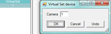

Virtual Set
You can specify camera to take in a virtual set.
Insert the camera number in the virtual set that is to be taken when the template is taken to Program.

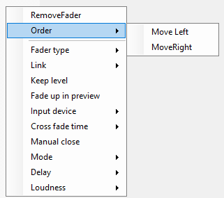

To Configure a Fader
Right-click over the fader to open the context menu and follow the Guidelines below.

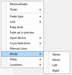

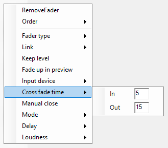

Guidelines for Audio Properties Configuration
Remove Fader |
Removes the fader from the template. |
Order |
Re-arranging the order:
Fader type |
Action: When a fader control is set as an action fader, the controls define whether the fader is enabled or disabled. Level: For normal operation.
Link |
Assigns a video/audio link group to this fader.
Keep level |
Keeps the fader level until manually changed. |
Fade up in preview |
Fades up audio in preview, when camera is in program. Enable to let the audio fader open when the template is cued in program. |

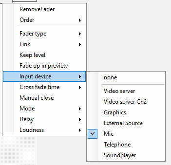

Input device |
Sets the type of the audio fader.
Crossfade time |
Sets the in and out crossfade time for the fader.
Manual close |
Select to ignore sending Close-level commands to audio mixer. |

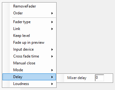

Mode |
Only for Studer Vista and Lawo! Sends the chosen value to the mixer board for the audio fader.
Delay |
Only for Studer Vista and Lawo! Gives a delay value for that audio fader that will be sent to the audio board.

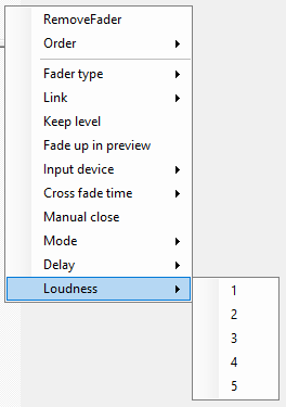

Loudness |
Sends chosen recall value to send to the Junger audio processor.
