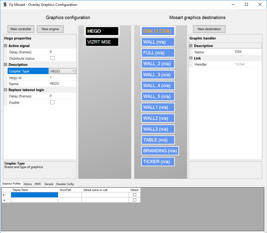

New controller: Adds a new controller.
New engine: Adds a new engine.
When a controller has been clicked on:
Example Hego
Active signal
Delay (frames): Displays an integer value indicating a number of frames to be delayed. Default: 0.
Distribute status: Displays a checkbox indicating whether the selected controller is set to distribute status. Default: Unchecked.
Description
Graphic Type: Displays the selected controller type from a dropdown list of possible controllers.
Hego Id: Displays an integer value indicating the selected controller's ID number.
Name: Displays the written name of the selected controller.
Replace takeout logic
Delay (frames): Displays an integer indicating a number of frames to be delayed. Default: 0.
Enable: Displays a checkbox indicating whether the Replace takeout logic has been enabled. Default: Unchecked.

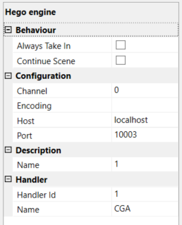

When an engine has been clicked on:
Example Hego engine
Behaviour
Always Take In: Displays a checkbox indicating whether the selected engine is set to always taking in . Default: Unchecked.
Continue Scene: Displays a checkbox indicating whether the selected engine is set to continue the scene . Default: Unchecked.
Configuration
Channel: Displays an integer value indicating the channel. Default: 0.
Encoding:
Host: Displays the host identification name. Default: localhost
Port: Displays an integer value indicating the selected engine's port number. Default: 10003.
Description
Name: Displays an integer value indicating the selected engine's ID number. Default: 1.
Handler
Handler Id: Displays an integer value indicating the selected engine's ID number. Default: 1.
Name: Displays the name of the engine handler.
Bottom of Panel (information)
Further details about the active property
Panel 1B
This section contains a list of controllers.
For each controller, potentially a sub-list of engines.

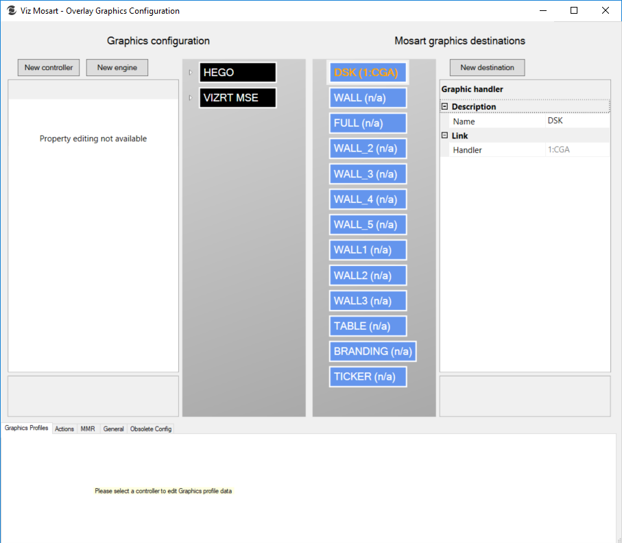

Panel 2 - Mosart Graphics Destinations
Panel 2A
A list of destinations.
The activated destination is indicated in orange.
Multiple engines can be assigned to:
The same destination (Mirrored Graphics Playout), where you use identical graphics concepts.
Different destinations with different names, where you use separate concepts for each output.
Different destinations with the same name, for example, playing out the same graphics on multiple parallel outputs, either in a virtual set configuration or in a multi-branding setup.
Panel 2B
New destination: Adds a new destination.
Graphic handler
Description: Displays the selected, named destination.
Link: Displays a concatenation of the Handler Id and the Handler Name separated by a colon. This information indicates the graphics handlerlinked to this specific destination.
Panel 3 - Property Tabs
Graphics Profiles
Only available when the selected item is a controller.
Display Name
Default scene on wall:
Default: Indicates whether the entry may be set as default.
Default: Unchecked
ShowPath:
Actions
Only available when the selected item is an engine.
Event:
Action:
Value:

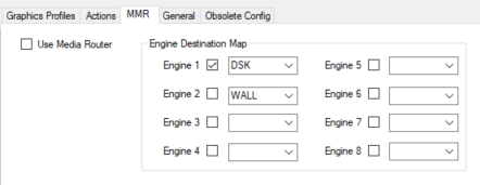

MMR
Use Media Router: Displays a checkbox indicating whether to use a Mosart Media Router. Default: Unchecked.
Engine Destination Map
Engine 1 [to 8]: Displays a drop-down list of possible destinations to be linked to this engine. A checkbox gives the opportunity to set the destination. Default: Unchecked.

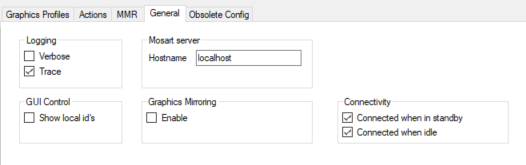

General
Logging
Verbose: Displays a checkbox indicating that verbose actions are logged. Default: Unchecked.
Trace: Displays a checkbox indicating that trace actions are logged. Default: Checked.
GUI Control
Show local id's: Displays a checkbox indicating whether local IDs should be displayed. Default: Unchecked.
Mosart server
Hostname: Displays the hostname for the Mosart Server. Default: localhost.
Graphics Mirroring
Enable: Displays a checkbox indicating that graphics mirroring has been enabled. Default: Unchecked.
Connectivity
Connected when in standby:Mosart Server remains connected during periods of standby mode.
Default: Unchecked. -
Connected when idle:Graphics devices will not be disconnected when put in idle (For example, when switching from main to backup).
Default is unchecked

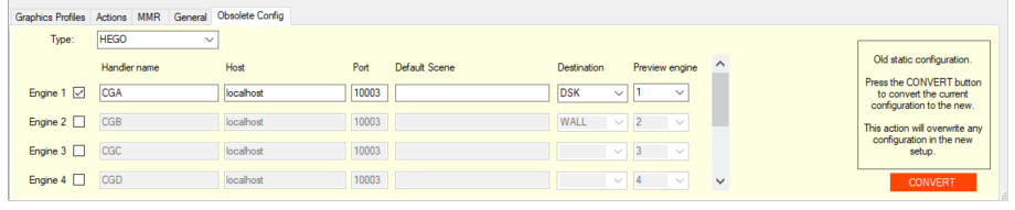

Obsolete Config
Overwrite Alert: Clicking the red CONVERT button in the Obsolete Config tab overwrites your existing configuration. Be sure about the consequences before you decide to click it.
Type: Displays a drop-down list of the available controller types.
Engine
Engine activation: Activates the engine by checking the checkbox.
Handler name: Sets the name of the engine handler.
Host: Sets the name of the host.
Port: Sets the port number.
Default Scene: Sets the default scene.
Destination: Sets the destination by selecting one from the dropdown list.
Preview engine: Sets the order of the preview engines.
Old static configuration: This part of the form is considered obsolete, hence the tab name.
Obsolete Configuration Notification: The red CONVERT button in the Obsolete Config tab is intended only for users who previously have been working with the old configuration and want to convert the old configuration and replace the current configuration.
