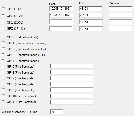

AV Automation Devices - GPI/IO
GPO (1-12): Check to enable a WebIO box for the first 12 GPI/O.
GPO (13-24): Check to enable a WebIO box for the second 12 GPI/O.
GPO (25-36): Check to enable a WebIO box for the third 12 GPI/O.
GPO (37-48): Check to enable a WebIO box for the fourth 12 GPI/O.
Host: Hostname or IP address to the WebIO GPI box.
Port: Port to communicate with the HTTP WebIO protocol.
Password: Defines the password, if needed.
GPI 0 (check box): Enable initialize Viz Mosart rundown when external pulse is received.
GPI 1 (check box): Enable start/continue the Viz Mosart timeline from an external pulse.
GPI 2 (check box): Enable starting Viz Mosart rundown on first story on external pulse.
GPI 3 (check box): Enable rehearsal mode off.
GPI 4 (check box): Enable rehearsal mode on.
GPI 5-11 (check boxes/custom): Enable firing of the template or command given in the text box.
