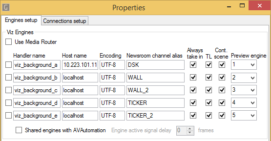

Engines Setup Tab
Go to Trio Interface > Settings > Properties > Engines setup tab
images/download/attachments/28380179/configuration_mmtrio-engine-setup.png
  • Viz Engines
    • Use Media Router: Check for using Media router.
    • Viz Engines: Use the check box to activate or deactivate connection to the Viz Engines configured in the corresponding row.
    • Handler name: Internal Media Sequencer handler name.
    • Host name: IP address or hostname of the Viz Engine.
    • Encoding: Font encoding on the Viz Engine. Use UTF-8.
    • Newsroom channel alias: Alias to be used from the NCS to direct the lower third or video wall element to the correct engine.
    • Shared engines with AVAutomation: Enable the check box if the Trio Interface and the AV Automation are sharing play-out on the engines. If enabled, the Trio Interface will signal the AV Automation when there are no Viz Mosart controlled lower thirds on-air, allowing for any cued full screen graphics controlled through the AV Automation to re-cue. The engine configuration must be the same in both applications.
    • Always take in: Check to always force a take-in command to be sent.
    • TL: Check to specify that Transition Logic shall be used.
    • Cont. scene: Use Continue for takeout of scene based graphics.
    • Preview engine: Indicate which Vizrt engine to be used for preview of overlays.
    • Shared engines with AVAutomation: This functionality will assume that the graphic configuration in AV Automation is equal to in Viz Trio. Viz Trio will protect the engine from being used by AV Automation when CG is active in Viz Trio.

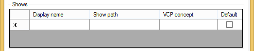

  • Shows
    images/download/attachments/28380179/configuration_mmtrio-vizshow-setup.png
    • Display name: The name of the show that will be shown in the drop down list in the Viz Mosart GUI. Please note that when using Concept Override, this name must be identical to the Viz Pilot concept.
    • Show path: Viz Trio path for the show.
    • VCP concept: Name of the Viz Pilot concept.
    • Default: Enable to make the row the default show for the gallery.

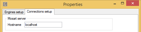

Connections Setup Tab
Go to Trio Interface > Settings > Properties > Connections setup tab
  • Mosart Server
    images/download/attachments/28380179/configuration_mmtrio-viz-manus-setup.png
    • Hostname: Hostname or IP address of the computer running the Manus Administrator application. Default: localhost

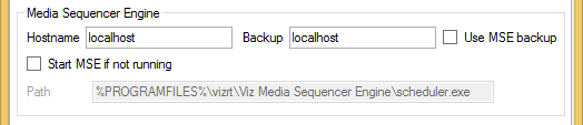

  • Media Sequencer Engine
    images/download/attachments/28380179/configuration_mmtrio-mse-setup.png
    • Hostname: Hostname or IP address of the primary Media Sequencer.
    • Backup: Hostname or IP address of the backup Media Sequencer.
    • Use MSE backup: Check this box to initially start using the backup Media Sequencer instead of the primary.
    • Start MSE if not running: If the Media Sequencer is not running when Trio Interface is started, it will try to start from the location described under (only valid if the Media Sequencer is running as a console application on the same machine).
    • Path: Path to the scheduler.exe in the Media Sequencer program files folder (only if Media Sequencer is running as a console application on the same machine).

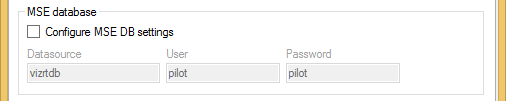

  • MSE Database
    images/download/attachments/28380179/configuration_mmtrio-mse-db-setup.png
    • Configure MSE DB settings: Enable to update the database settings in the Media Sequencer with the details below.
    • Datasource: TNS name or connection string of the Oracle database.
    • User: Username on the Oracle database.
    • Password: Password on the Oracle database.
