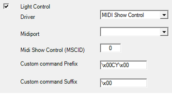

Light Control: Check to enable the Light control through MIDI Show Control.
Midiport: System MIDI port to communicate with the Light board.
Midi Show Control (MSCID): The MIDI Show Control ID that is used for communicating with the Light board. Default: 0
Custom command Prefix: This is the prefix test sent with the MIDI Show Control command. Characters can be escaped using the x00 where 00 is replaced by the numeric value of the character. Default: \x00CY\x00
Custom command Suffix: This is the suffix sent with the MIDI Show Control command. Characters can be escaped using the x00 where 00 is replaced by the numeric value of the character. Default: \x00
