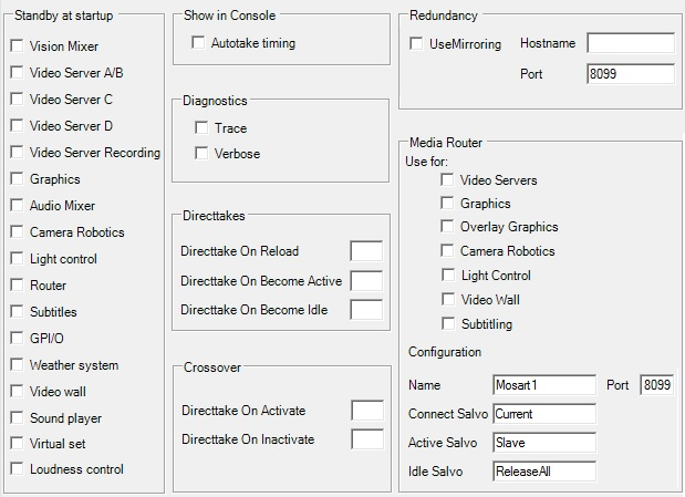

Standby at startup
  • Select the drivers to start in standby mode. They must be taken out of standby manually.
    Show in Console
  • Autotake timing: Adds timing to the log window. Used for debugging purposes.
    Diagnostics
  • Trace: Adds logging information to console used for dbugview.
  • Verbose: Increases logging information from AV Automation to the log file.
    Directtakes
  • Directtake On Reload: The number of the directtake template to be fired upon re-loading the rundown.
  • Directtake On Become Active: The number of the directtake template to be fired when the server becomes active from idle, when switching between main and backup Viz Mosart servers.
  • Directtake On Become Idle: The number of the directtake template to be fired when the server becomes idle from active, when switching between main and backup Viz Mosart servers.
    Crossover
  • Directtake on Activate: The direct take number to be taken when this server goes active in crossover switch.
  • Directtake on Inactivate: The direct take number to be taken when this server goes inactive in crossover switch.
    Redundancy
  • UseMirroring: Check to enable mirroring. Upon enabling mirroring on both main and backup server, the settings will be synchronized.
  • Hostname: Hostname or IP address of the Backup Server if using Main Server, and vice versa.
  • Port: IP port number of the Backup Server if using Main Server, and vice versa.
    Media Router
  • Use for: Select which controls should be used by the Media Router.
  • Name: Media router’s hostname or IP address.
  • Port: Media router’s connection port number.
  • Connect Salvo: The salvo name to be taken when this server connects after restart. Default: Current
  • Active Salvo: The salvo name to be taken when this server becomes the active server from being idle. Default: Slave
  • Idle Salvo: The salvo name to be taken when this server becomes idle after being active. Default: ReleaseAll
