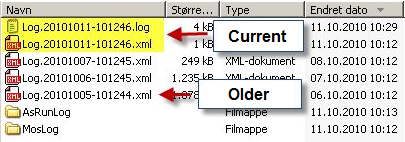

Current and Previous Files
There are two sets of log files:
The current log file, which is active.
For efficiency purposes, this log is divided into two separate files; one .XML and one .log
When reading the current file it is recommended to open the .XML, as this contains a reference to the corresponding .log file.
Previous log files.
When a new log file starts, the current active log is merged into a single .XML
The figure below shows the default setup with a list of log files belonging to the technical log and two directories containing similar log files for the AsRun and MOS logs respectively.
