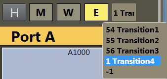

Next Transition
The type of the next vision mixer transition is shown in the transition area by highlighting the corresponding transition icon. Available transition types are Mix (M), Wipe (W) and Effect (E). In the value field to the right of the transition type boxes, the duration of Mix (M) or Wipe (W) is shown, or, for Effect (E), the name of the effect is shown.
The next vision mixer transition can be overridden by clicking on the corresponding transition icon in the transition area. For Mix (M) and Wipe (W) transitions, the duration of the transition (in frames) can be changed by clicking M or W, and then use the scroll-wheel, or right-click and drag up or down in the duration field.
Selecting Effect (E) and then clicking the empty square will cause a dropdown menu to appear, containing the transition effects stored in AV Automation's A/V Setup.
When Studio Setup is changed, the items in the dropdown are updated accordingly. For more information on configuring Studio Setup, see the Viz Mosart Administrator’s Guide > Audio and Vision Mixer Effect Setups.
The next transition type can also be selected by a TRANSITION TYPE control command. By default, this control command is assigned to the Tabulator key, which can then be used to cycle through the three transition types.
