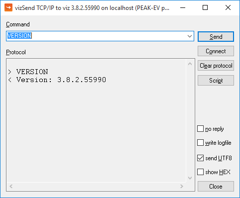

External Control Applications, such as Viz Trio and Viz Pilot, communicate with Viz Engine through External Control commands. Viz Engine supports a wide range of such commands. Any installation of Viz Engine and Artist also come with the application Viz Send, which mimics the behavior of External Control Applications.
External Commands can also be sent manually to Viz Engine through the console window, using the send command. External commands range from loading a scene and taking the scene on air, to shutting down Viz Engine. To issue a command to the Engine, open the console window and type send [COMMAND], then press enter. For example, the command VERSION can be used to display the current Viz version and build number:
send VERSIONCONSOLE: answer <Version: 3.8.2.55990>
