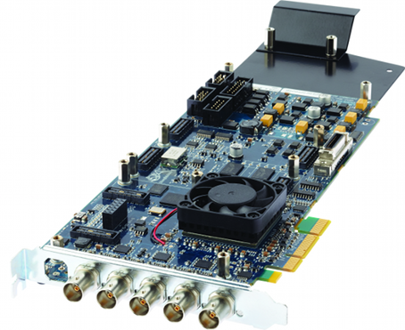

Viz Engine supports the following BlueFish444 video boards:
Epoch | 4K Supernova
Epoch | 4K Supernova S+
Epoch | Supernova CG
Epoch | Neutron (introduced in Viz version 3.7.0)
