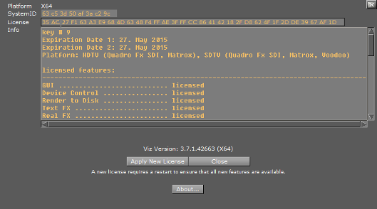

Open the License window:
If this is a first time license application or the license has expired, the License window will open.
If this is a new license application before a license expiry date, click on the License Information button.
Check that the Dongle ID, in the License Information text file, is the same as the System ID in the License window.
Check these details:
Check that the license string has 32 pairs of characters and that they are divided by a single space.
Check the characters and for spaces at the end.
Copy the license string from the License Information text file.
Paste the license string in the License field of the License window.
Check that the license key has not been entered twice.
Check that the whole string is pasted.
Click Apply New License.
Restart for the changes to take effect.
