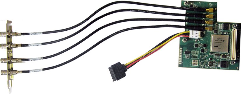

Connect the power cable to the X.RIO.
The slot panel has numbers from 1-4. Make sure to connect them carefully, as the mini-BNCs can break easily.

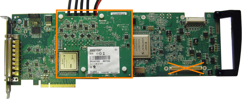

Mount the X.RIO on the X.mio2 board “Mod A” connector. The Mod B connector will not work.
Use the screws to fix the X.RIO expansion module.

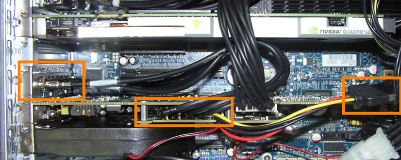

Tip: When installing an X.mio2 with X.RIO into a HP Z800, make sure that the mini-BNCs do not get disconnected during installation, as they are very hard to connect while the X.RIO board is mounted on the X.mio2.
Mount the slot panel with the 4 additional inputs in any free slot and connect the power for the X.RIO. Also, make sure the cables is not in touch with any fans.

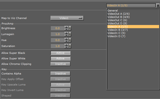

Start Viz Configuration, and go to the Matrox section. From the drop-down menu, the VideoIn parameters, for example E, F, G and H, can be configured. Note that the X.RIO inputs are mapped to Viz Engine’s channels 5-8 by default. This means that when an X.mio2/24 is in use, Viz Engine’s channels 3 and 4 are not in use.
