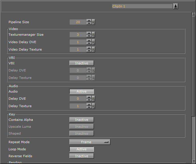

Use the Video Input: Clip Input panel to configure available playback channels. The number of available clip input channels is set in Video Input.
Clip Input Properties
Pipeline Size: Defines the number of frames Matrox’ internal clip reader buffer should buffer in advance. Default value is 20.
Texturemanager Size: Texture download buffer size.
Video Delay DVE: DVE Delay of video when used as DVE.
Video Delay Texture: Texture Delay of video when used as Texture.
VBI: Set to Active or Inactive. Defines whether VBI should be used for this channel. Default mode is Inactive.
Delay DVE: Sets the number of frames VBI should be delayed, before the clip can be used, in DVE mode. Default value is 0 (Off).
Delay Texture: Sets the number of frames VBI should be delayed, before the clip can be used, in texture mode. Default value is 1.
Audio: When activated, this setting enables audio for this channel. When inactive audio is disabled. Default value is Activated.
Delay DVE: Sets the number of frames the audio clip should be delayed in DVE mode before it can be mixed to the output. Default value is 4.
Delay Texture: Sets the number of frames the audio clip should be delayed in texture mode before it can be mixed to the output. Default value is 4.
Contains Alpha: Enables/disables playback of clips with alpha.
Upscale Luma: Enables/disables the default for upscale luma. Per scene setting of this value is set per clip channel under Scene Settings and Video clip options.
Shaped: Defines whether the fill from this channel, when the channel is used in DVE mode, should be interpreted as shaped video during DVE compositing. Default value is Inactive.
Repeat Mode: Determines the behavior of the video input in case of capture drops. Options are:
None: Does not repeat. Input goes black.
Field: Repeats the last field.
Frame: Repeats the last frame.
Loop Mode: Enables/disables default for loop mode. Per scene setting of this value is set per clip channel under Scene Settings and Video clip options.
Reverse Fields: Swaps fields when playing interlaced clips with negative playback speed (default setting). Per scene setting of this value is set per clip channel under Scene Settings and Video clip options.
Pending Enable: Enables/disables pending clip player for this channel. The pending clip player allows clip loading of another clip while the clip channel is still using the current clip.
Mode on Load Error: Determines the behavior of the current clip when loading of the pending clip fails. Options are:
None: Current clip mode is not changed.
Stop: Performs a Stop command on the current clip.
Pause: Current clip enters pause mode.
Flush: Unloads the current clip.
Proxy: If set to Active, video clips of a resolution different to the current configured resolution, can be played. If set to Inactive a video clip of a different resolution cannot be played.
Reactivation Delay: Set the minimum number of frames the texture contains black after the channel was activated to texture.
Ringbuffer: If set to Active the input ringbuffer is enabled when played with a NVIDIA SDI output.
