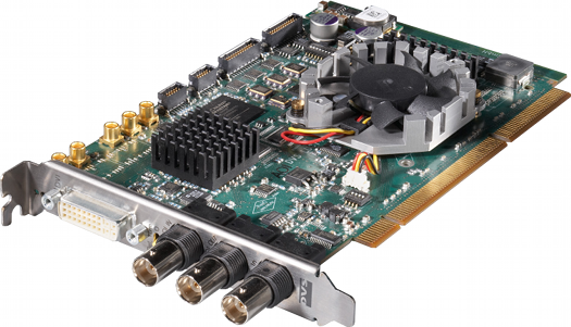

This section contains a description of the Digital Video Systems (DVS) Centaurus II video card.
The DVS was mainly sold with Viz Virtual Set and Viz Arena, and was Vizrt’s successor of the Digital Voodoo Red Devil V3 card. The DVS is able to output both HD and SD unlike the Red Devil which could only output SD. The DVS was typically mounted in HP wx8400, HP xw8600 or HP Z800 machines.

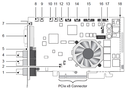

Main Card Connectors
Ref. In: BNC connector for the reference input. May be Bi-/Tri-Level sync.
DIP Switch for PCI: PCI-X variant only: DIP switch to set up the PCI video card interface, that is its clock frequency; This switch is not available on the PCIe version of the card used by Vizrt.
(HD) SDI OUT A: BNC connector for a video output at port A (serial digital interface); usually used for an output of the first video channel in single-link (YUV) or the first stream of YUVA or RGBA in dual-link mode.
(HD) SDI IN A: BNC connector for a video input at port A (serial digital interface); usually used for an input of the first video channel in single-link (YUV) or the first stream of YUVA or RGBA in dual-link mode.
Ref. Term: Termination switch for the reference input; switches off the termination of the GenLock signal manually, for example if the Centaurus II card is not the last link in a GenLock connection chain.
DVI OUT: DVI connector for an output of analogue and digital video signals.
LEDs: Two status LEDs (Red/Green) indicating the presence of correct video and sync signals (see also Description of the LEDs on the video card).
SD SDI IN1: MCX connector for an input of digital SD video signals (serial digital interface)
(HD) SDI IN B: MCX connector for a video input at port B (serial digital interface); usually used for an input of the second video channel in single-link (YUV) or the second stream of YUVA or RGBA in dual-link mode.
(HD) SDI OUT B: MCX connector for a video output at port B (serial digital interface); usually used for an output of the second video channel in single-link (YUV) or the second stream of YUVA or RGBA in dual-link mode.
SD SDI OUT1: MCX connector for an output of digital SD video signals (serial digital interface)-
CVBS OUT: MCX connector for a composite video burst signal, either analogue output of SD video or used for synchronization purposes.
GPI: Flat cable connector for the general purpose interface.
RS-422: Flat cable connector for an in- and output of RS-422 signals
AUDIO 1-8/LTC: Flat cable connector for the digital audio channels 1 to 8 and LTC.
DIP Switch for Flash Controller: This switch controls the operation of the on-board Flash controller; it defines the version set of the map file that will be loaded at startup. The image above depicts the default setting of the DIP switch for the Flash controller; please observe the orientation of the switch on the card.
Audio 9-16: Flat cable connector for the digital audio channels 9 to 16.
Breaking line: The printed circuit board provides at its bottom (PCIe variant only) and right side extensions void of any electrical parts; these may serve to stabilize the installation of the card in a computer system; when not needed or interfering, you can break them off the circuit board at the breaking line(s); see also dotted lines in figure 1 on the previous page.

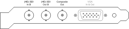

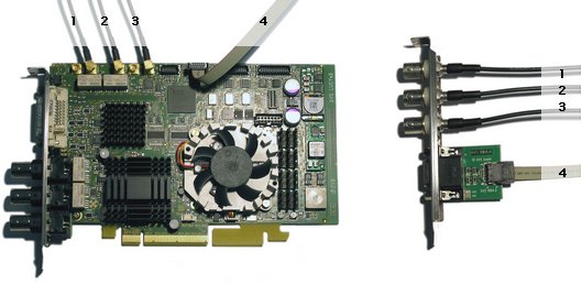

SDI and RS-422 Extension Card Connectors
The SDI and RS-422 panel is included in the standard configuration of DVS Centaurus II. It provides the connectors for the second link of the dual-link connections. Additionally a CVBS output is installed on this panel that provides a composite video signal showing the fill signal generated by Viz Engine.
The RS-422 connector available on the panel is a DB-15 (HD) connector.
Note: This connector does not provide any additional functionality in regards to Viz Engine and should be ignored. The RS-422 port is not accessible to the operating system and can therefore not be used to transceive any kind of data by third-party applications.
(HD) SDI In B: BNC connector for a video input at port B (serial digital interface); usually used for an input of the second video channel in single-link (YUV) or the second stream of YUVA or RGBA in dual-link mode.
(HD) SDI Out B: BNC connector for a video output at port B (serial digital interface); usually used for an output of the second video channel in single-link (YUV) or the second stream of YUVA or RGBA in dual-link mode.
CVBS Out: BNC connector for a composite video burst signal, either analogue output of SD video or used for synchronization purposes. Provides the fill output of Viz engine as an analogue signal.
RS-422 In & Out: DB-15 (HD) connector (female), serial RS-422 interface for master/slave control, a breakout cable to two DB-9 connectors is included in the delivery.
Note: This RS-422 connector is inactive and not accessible to the OS and can therefore not be used to transceive data.
To Connect the DVS Centaurus II and SDI/RS-422 Extension Card
Connect the separate SDI/RS-422 panel with the DVS Centaurus II main card according to the enumeration shown in the illustration above.

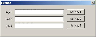

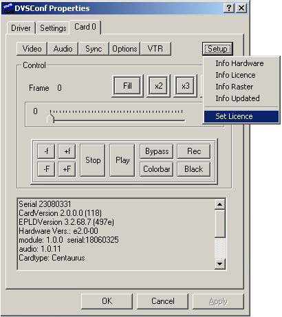

To Install a DVS Centaurus II License
Locate and double-click the dvsconfig.exe file located in the driver folder downloaded from Vizrt’s FTP.
Select the Card 0 tab.
When selecting the Card 0 tab for the first time the system will inform that a license needs to be installed for the product.
Click OK to close the DVSConf Warning dialog box.
Click the Setup button and select Set License from the appearing drop-down menu.
Enter the license key in field Key 1 and click the Set Key 1 button.
Note: It has been reported that the key might be ignored and that validation fails although it was correctly entered. Re-enter the license string and try again.

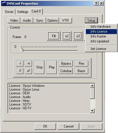

To validate the DVS Centaurus II license
Click the Setup button and select Info License from the appearing drop-down menu.
Check the following entries (bottom of the dialog box):
License : Opsys Windows
License : Opsys Linux
License : OEM
License : Multidevice
License : Audio
License : Hires
License : SDTV
License : HDTV
License : 12Bit
License : Processing
License : Mixer
License : ZoomAndPan
License : ColorCorrector
License : HDTVKeyChannel
License : HDTVDualLink
License : SDTVKeyChannel
License : SDTVDualLink
Once all licenses are verified, click OK to close the program.
