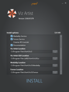

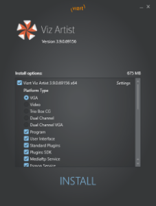

Run the installer. The bundle installer provides an overview of all required dependencies that will be installed in addition to the main application. Already installed dependencies are listed as Installed. You can collapse the selection list by clicking Settings.
Note: The bundle installer selects most features by default. Check the feature list and add or remove features as required.
Scroll further down to select a custom installation location, if required.
Click install to complete the installation wizard. The various dependencies are installed as required.

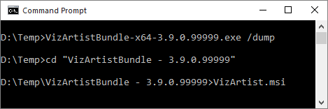

The bundle installer does not support silent installation, which requires that you install each package separately. Extract all packages from the bundle by adding the /dump command line option.
This will create a sub-folder containing all packages contained in the bundle installer. Use the VizArtist.msi file located in this sub-folder for unattended installations. This is useful in large-scale enterprise deployment.
IMPORTANT! The VizArtist.msi installation file does not support upgrades, and will terminate without installing. Enable logging and specify a log file to keep track of any issues during silent installation.
Run the following from a command line prompt, or save it to a batch file for execution:

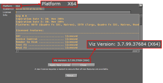

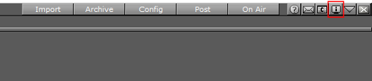

To check if Viz Artist is a 64-bit or 32-bit installation, click on the Show License Information button:
In the License Information window, the platform and Viz version number show as:
Platform: Win32 (32-bit) or X64 (64-bit).
Viz Version: 3.7.XX.XXX (Win32) or (X64).
