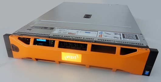

Dell R7910 (2U) Rack Server
The Dell R7910 Rack Workstation is a high-performance 2U Rack server. It is a dual-CPU server with 24 DIMMS memory slots, and can be configured with high-end Quadro graphics, Matrox Video I/O, and AES Audio.

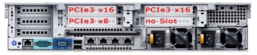

Dell R7910 Rack Workstation slots
The server have 4 slots for expansion cards. One slot is not connected to the motherboard, as indicated with no-Slot in the picture below:
To setup a single channel graphics with Video and AES Audio
Graphic card in PCIe3 x16 above the power supply.
Matrox card in PCIe3 x8.
AES Audio above the Matrox card.
To setup Dual Channel with two K4200 graphics cards
Both K4200 in the PCIe3 x16 slots.
Matrox card in the PCIe3 x8 slot.
AES Audio in the “no Slot”, as this does not need connection to the motherboard.
