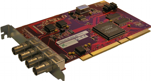

BlueFish444 Iridium|SD is the native successor of the Digital Voodoo DeepBlue LT and the predecessor of BlueFish444 SD Lite Pro Express, providing Fill, Key, GenLock and Composite Fill connectors. The Iridium|SD is fully compatible with older DeepBlue-LT installations.
The card was mostly used with Viz Trio NV which basically was a system with the ability to run a Viz Trio client with local preview and video output on a single machine; hence, there was no video input or video playback support as with the Matrox X.mio Series. The local preview was able to render a different scene than the one being output on video. The card was typically seen on HP xw4600.

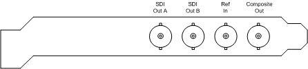

The BNC connectors from left to right are:
SDI Out A (Fill) - SDI 4:2:2/4:4:4/Video
SDI Out B (Key) - SDI 4:2:2/4:4:4/Video
Ref In - Analog GenLock input
Composite Out - Composite fill output
