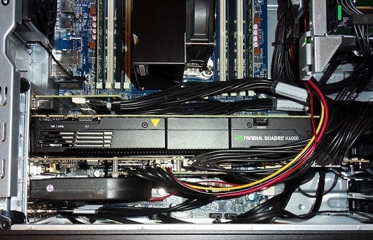

This section describes how to setup a HP Z440 machine with the different cards provided by Vizrt. The HP Z440 (4U rack units) is a high performance single-CPU workstation with 8 memory slots, multiple storage and PCIe configuration options.
More details about the HP Z440 can be found on HP’s website: HP Z440 Info.
HP Z440 with NVIDIA K6000 card, Matrox X.mio2:
HP Z440 PCI/PCIe Slot layout and usage
Slot ¤ |
Type |
Used for |
13 |
PCIe2 x1 |
AES Audio card (if the video card has it) |
14 |
PCIe3 x16 |
Graphic card |
15 |
PCIe2 x4 |
Unused/Free |
16 |
PCIe3 x8 |
Video Card (Matrox, DVS or Bluefish) |
17 |
PCIe3 x16 |
Radial Aerator, if needed, see note below |
18 |
PCI 32/33 |
Unused/Free |
Note: Radial Aerato is recommended for the X.mio2 and X.mio2 Plus boards. However, for video cards that have an onboard fan, such as the X.mio3, DSX LE 4, DVS Atomix or Bluefish Epoch 4K Supernova cards, this is not needed.
