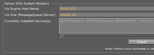

Fsmon Service Only:
Enter the host name of the local host.
Enter the host name of the Viz One Message Queue Server.
IMPORTANT! The local host name must be exactly the same string that was entered in the Viz One as host name for the Viz Engine (it must be the exact same string as seen beside Host on the Servers page).

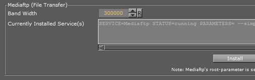

MediaFTP Service Only: Set the transfer band width (Kbits per second), as required.
Note: Mediaftp is installed with the -a flag. This assumes that the default Viz One user/password combination is: vtrsync/vtrsync. Mediaftp will install, but not work, if the user/password combination is different (see Adding a Viz Engine in the Viz One Administrators Guide).
Click on Install for each required Service.

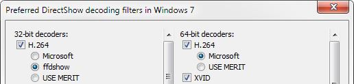

To Set a Preferred Decoder
Run the Windows 7 DirectShow Filter Tweaker
In the appearing dialog box click Preferred decoders
Set your MPEG-4/H.264 32-bit decoder to FFDShow.
Click Apply & Close.
Click Exit.

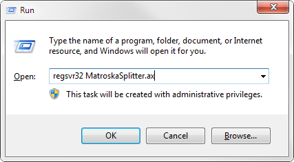

To Register the Matroska Splitter
Extract the Matroska Splitter
Copy the ax file to your C:\Windows\System32 folder
Note: There are two files available, one in the root folder that is used for 32-bit systems, and one in the x64 folder used for 64-bit systems.
Click on Start > Run
Enter regsvr32 MatroskaSplitter.ax.
Click OK. A message box appears confirming your registration.
Click OK.
