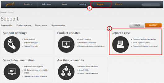

Go to www.vizrt.com.
Click on Support (1).
Click on Report a case (2).

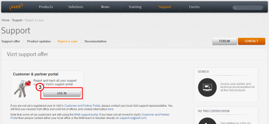

Click on LOG IN (3).
Log-in to the Customer and Partner portal.

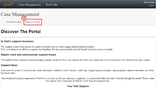

Click on Report a Case (4).
