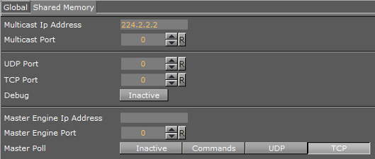

To Synchronize a Viz Engine with TCP or UDP
Go to the Configuring Viz.
Click on Communication.
Click on the Shared Memory Properties tab.
Enter the TCP or UDP port number.
Always make sure that the selected port number is not in use by any other program on the same subnet.
In Master Engine Ip Address type the Ip address of a running Viz Engine to synchronize with. Example <IP/hostname of Viz Engine 3>.
Note: Must be the IP address of a running Viz Engine in the same cluster system.
In Master Engine Port, type the port number to be used (default 6100).This port sends the single startup synchronization command to start synchronizing. It should be the same as the general communication port of the Viz Engine set in Master Engine IP Address.
In Master Poll, select UDP or TCP as selected in step 4.
Click Save.

In the Shared Memory panel set these parameters:
Master Engine Port: Enter the communication port of the Master engine (default is 6100).
Master Poll: Click on Commands.
Click Save.
