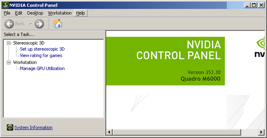

Missing NVIDIA Control Panel settings
Please perform a re-installation of the NVIDIA driver as mentioned in section Steps to recover from severe NVIDIA Mosaic driver related issues. A known cause for this behavior are physical changes to an existing video-wall setup, for instance adding or removing monitors, while operating in Mosaic mode.
