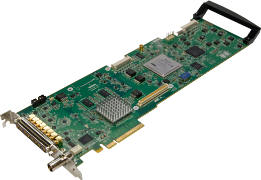

The connectors for X.mio2 and X.mio2 Plus are:
PCIe board compliant to PCIe 2.0 in x8 or x16 slot
x2 or x4 SDI video inputs in SD and HD
x4 SDI video outputs in SD and HD
x16 In / x32 Out, unbalanced AES/EBU audio
Because of the large number of I/O connections, the X.mio2 and X.mio2 Plus boards are equipped with Sub-D connectors. A breakout-cable or rack mountable Break Out Box (BOB), which translates the Sub-D connectors to regular connectors/plugs, is included for every machine.

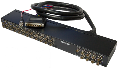

Breakout Cables and Connectors
A Breakout Box (BOB) is often used for Viz Engine solutions that need to be rewired in regular intervals. The 1U Rack unit chassis is designed to fit into a standard 19” rack.
Video Cables for X.mio Series
This image shows the cables responsible for transmitting any video related signals to and from the X.mio2 Plus board.

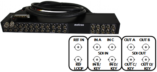

Video Connectors for X.mio2 Plus
The front panel of the X.mio2 Plus breakout box provides the user with 8 or 9 standard BNC connectors.
x2 or x4 HD/SD SDI In
x4 HD/SD SDI Out
x1 Analogue Ref In

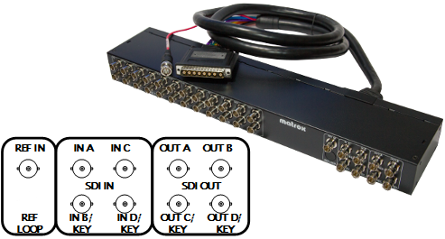

The front panel of the X.mio2/2 Plus breakout box provides the user with 8 or 10 standard BNC connectors.
x4 HD/SD SDI Out
x1 Analogue REF IN
x1 Analogue REF LOOP
IMPORTANT! When using the REF IN connector on the Matrox X.mio2 board for synchronization, the REF LOOP connector must be terminated with a 75 Ohm resistor unless it is being used to loop an incoming Genlock signal.

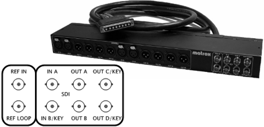

The front panel of the X.mio breakout box provides the user with 8 standard BNC connectors.
x2 HD/SD SDI In
x4 HD/SD SDI Out
x1 Analogue REF IN
IMPORTANT! When using the Ref. In connector on the Matrox X.mio board for synchronization, the Ref. Out Loop connector must be terminated with a 75 Ohm resistor unless it is being used to loop an incoming Genlock signal.

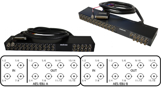

Audio Connectors for X.mio2 and 2 Plus
On the X.mio2/2 Plus breakout box, each of the two audio bays, A and B, consists of four female BNC audio input channels and of eight female BNC audio output channels.
Note: Bay cables are not included.
On the backside of each breakout box there are two connectors labeled AUDIO-A and AUDIO-B. The included cables are used to connect the corresponding plugs of the X.mio series to the computer.

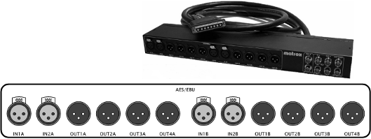

The front side of the X.mio breakout box hosts various audio in- and outputs. Each of the two audio bays, A and B, consists of two female AES/EBU audio input channels and of four male AES/EBU audio output channels.
Video Cable Assignment
Connect the relevant video input(s) and output(s), and the reference signal(s) as per the labels attached to each cable.
A reference signal can be attached to the reference input connector ANALOG REF IN, which can be fed with any analogue Genlock signal, such as a black burst or Tri-level as required.
If the reference signal used for synchronization is relayed from a Matrox X.mio and X.mio2 to a graphics card, make sure to check that all internal connections between the graphics card and its SDI extension are connected correctly, and that the extension is correctly supplied with power.
When the ANALOG REF IN connector is used with a Matrox X.mio or X.mio2 board for synchronization, the ANALOG REF LOOP OUT connector must be terminated with a 75 Ohm resistor unless it is being used to loop an incoming Genlock signal. The ANALOG REF LOOP OUT for the X.mio2 Plus is terminated by default, and so only supports REF IN on the actual board.

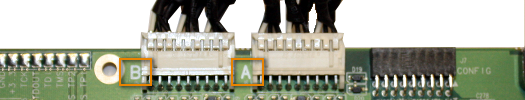

To Connect the Audio-extension Card to the Video Board
IMPORTANT! The Matrox audio-extension card only supports digital audio.
Locate the connectors on the audio-extension card labeled A and B.
Locate the connectors on the video board labeled A and B.
Use the cables to connect A on the audio-extension card to A on the video board, and do the same for the B connectors.

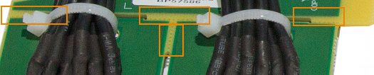

To Remove the Audio-extension Card Back-end
Locate the audio-extension card’s weak spots
Carefully break the connections.
Caution: Do not break the weak spots that hold the two remaining pieces together.
