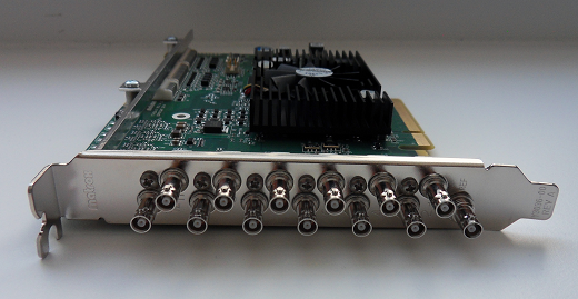

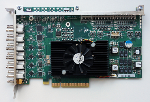

X.mio3 FH
X.mio3 FH provides multichannel SDI IO with hardware based video processing in a full-height, half-length PCI express card with 13 physical HD-BNC connectors. This card provides up to 12 reconfigurable I/Os, from SD to 4K, one connector is reserved for sync. Support for AES/EBU, LTC and GPIO provide for versatile connectivity. The multi-channel hardware processing accelerates compute-intensive operations including motion-adaptive de-interlacing, up/down/cross scaling and mixing/compositing for all resolutions, including 4K.

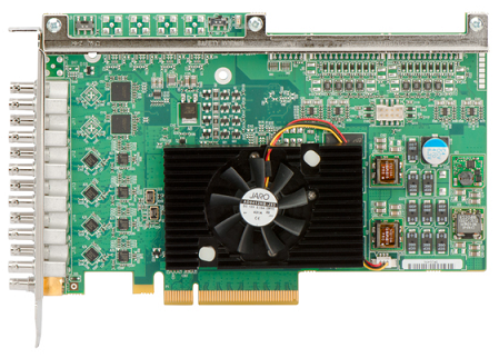

X.mio3 LP
Matrox X.mio3 LP is a low-profile, half-length PCIe card with up to eight reconfigurable SDI I/Os from SD to 4K.

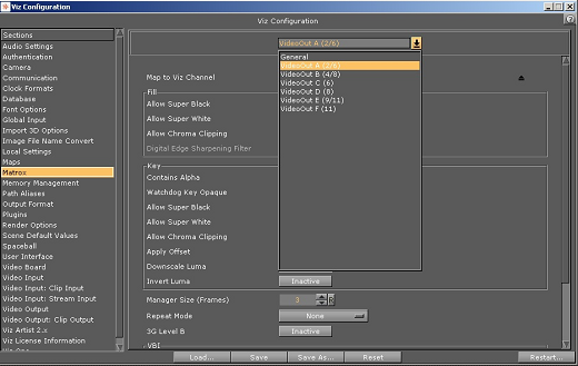

Open VizConfiguration > Matrox to configure the Matrox video channel mapping and mapping type.
The Viz video inputs are named alphabetically and limited to the number of available I/O channels the system has. The number in parenthesis indicates which channel is being used for fill and key.If you do not need a key signal in the output, de-select the Key > Contains Alpha option to make the I/O channel available for other usages. Example configuration:
In the example above, the X.mio3 card is configured with 6 outputs (named VideoOut A to F) and no inputs. The numbers within the trailing parentheses reflect which IO-channel is being used for fill and key, respectively. This means VideoOut A uses IO-channel 2 for fill and IO 6 for key, VideoOut B uses IO 4 for fill, IO 8 for key, while VideoOut C only has fill using IO 6, and so on.

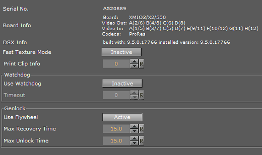

Navigate to Config > Matrox > General for an overview showing which I/O channels are used for fill and key, as illustrated in the Board Info section of the screenshot below:

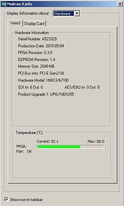

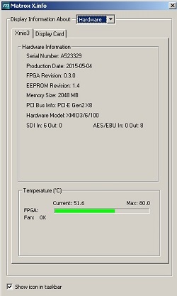

The Matrox X.info utility is used to display information about the card class, how the Input and Outputs are configured, serial number and more. This utility can normally be started from the Windows taskbar. A typical information window would be:

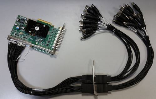

The X.mio3 AES Audio Kit connects to the X.mio3 card internally and takes up one slot as indicated in the picture below:
The kit contains:
2 internal cables with bracket
2 external cables, each cable has:
8 AES/EBU in and 8 AES/EBU out
4 LTC in and 4 LTC out
Total 16 AES/EBU in and out
Total 8 LTC in and out
