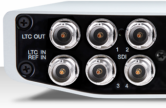

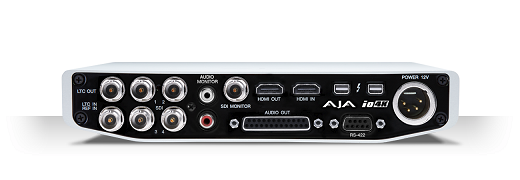

The six BNC connectors on the back of the Io4K are labeled [LTC OUT], [LTC IN/REF IN] and [SDI 1 to 4] as indicated in the picture below:
The default configuration is:
Viz Reference |
Io4K BNC Connector |
Live Input 1 |
SDI 1 |
Live Input 2 |
SDI 2 |
Fill Output exits from: |
SDI 3 |
Key Output exits from: |
SDI 4 |
Genlock |
[REF IN] |
If Live Input 2 is inactive in the configuration, SDI 2 will be enabled for preview output.

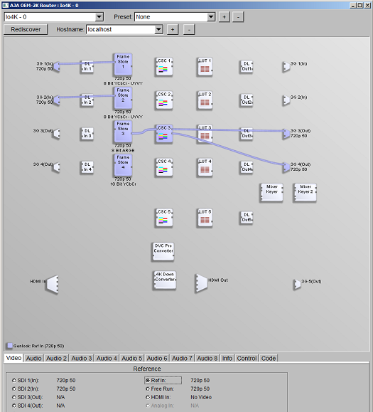

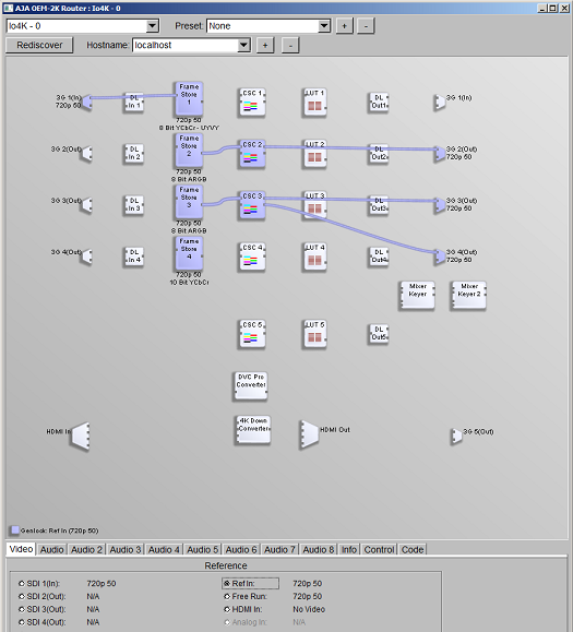

cables.exe This utility shows the current topology running: inputs, outputs, color space conversion, fill and key paths. Firmware and driver version information is also accessible. Screen-shots of cables.exe usage showing two typical topologies (A: two video inputs and B: one video and one preview) are shown below
Example A- topology using two video inputs:
Example B- One video input, one preview:
