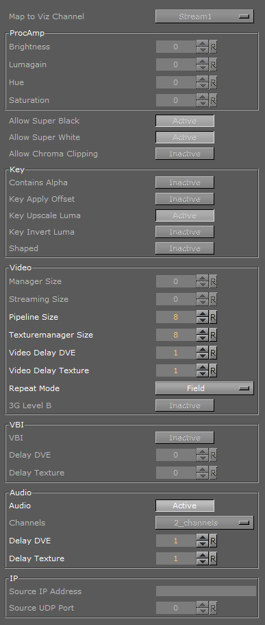

Use the Video Input: Stream Input panel to configure available IP stream input channels. The number of available IP Stream input channels is set in Video Input.
Stream Input Properties
Map to VizChannel: Set which video in channel is mapped onto this Matrox video in channel. The drop-down gives a choice between the available channels. Only the channels not already taken are shown.
Unused: Do not use this Matrox channel for video input
Video <1 to 8>: Captured input is available in Video1.
ProcAmp Properties
Brightness: Sets the relative offset on the luminance component of the incoming video (min./max. values are dynamic and determined by the hardware). Default value is 0 (Off).
Lumagain: Sets the gain on the luminance component of the incoming video (min./max. values are dynamic and determined by the hardware). Default value is 0 (Off).
Hue: Sets the color shift on the chrominance component of the incoming video (min./max. values are dynamic and determined by the hardware). Default value is 0 (Off).
Saturation: Sets the gain on the chrominance component of the incoming video (min./max. values are dynamic and determined by the hardware). Default value is 1 (On).
Fill Properties
Allow Super Black: Determines whether or not to clip an output video signal that is under 7.5 IRE units. Default mode is Inactive.
Allow Super White: Determines whether or not to clip an output video signal that is over 100 IRE units. Default mode is Inactive.
The colorimetry tables for SD (ITUR-BT 601) and HD (ITUR-BT 709) define a color conversion from YUV with the range of 16-235 to RGB with the range of 0-255. Values above 235 are Super White and values below 16 are Super Black. As Super White and Super Black pixels are outside the range of 1-byte RGB, these pixels will be clamped to the normal 16-235 YUV range when used in a texture. -
Allow Chroma Clipping: Determines whether or not to clip over-saturated chroma levels in the active portion of the output video signal. Default mode is Inactive.
Key
Contains Alpha: Enables/disables playback of clips with alpha.
Key Apply Offset:
Key Upscale Luma:
Key Invert Luma:
Shaped: Defines whether the fill from this channel, when the channel is used in DVE mode, should be interpreted as shaped video during DVE compositing. Default value is Inactive.
Video
Manager Size:
Streaming Size:
Pipeline Size: Defines the size of the input queue. Default value is 8.
Texturemanager size: Pre-allocated texture buffer size, in frames.
Video Delay DVE: DVE video delay when used as DVE.
Video Delay Texture: Texture video Delay when used as Texture.
Repeat Mode: Determines the behavior of the IP stream input in case of capture drops. Options:
None: Does not repeat. Input goes black.
Field: Repeats the last field.
3G Level B: Activates Level B for 3G mode in 1080p50/60/60M. Default mode is Level A.
VBI
VBI: Defines whether VBI should be used for this channel. Default mode is Inactive.
Start Line: Defines at which line on the input the VBI section will start. Default value is 0 (Off). The minimum VBI values are (as for VideoOut):
NTSC: 7
PAL: 6
720p: 7
1080i: 6
Delay DVE: Sets the number of frames VBI should be delayed, before the IP stream can be used, in DVE mode. Default value is 0 (Off).
Delay Texture: Sets the number of frames VBI should be delayed, before the IP stream can be used, in texture mode. Default value is 1
Audio
Audio: When activated, this setting enables audio for this channel. When inactive, audio is disabled. Default value is Activate.
Channels: Sets the number of audio channels to capture (see also Audio in Viz).
Default number of channels are 2. Available channel options for AES on X.mio are: -
None, 1, 2, and 4.
For AES on X.mio2/X.mio2 Plus and for Embedded the channel options are: -
None, 1, 2, 4, 8, and 16.
Delay DVE: Sets the number of frames the audio clip should be delayed in DVE mode before it can be mixed to the output. Default value is 4.
Delay Texture: Sets the number of frames the audio clip should be delayed in texture mode before it can be mixed to the output. Default value is 4.
IP
Source IP Address: Sets the IP address of the source. Must be an IP in the multicast address range, such as 224.10.10.31 or 239.10.10.51.
Source UDP Port: Sets the port of the source.
Shared Memory
Unique Identifier: Change the name of the Shared Memory, if required. Not available on systems with Matrox X.mio3 IP video boards.
