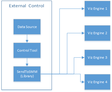

Data feed into the Shared Memory (SMM) should be done through the dedicated UDP or TCP IP ports for the SMM. Vizrt provides a set of components, SendToSMM, to makes this task easier.
Note: Go to <Viz Install Directory> -> Tools -> SendToSMM, for more information about SendToSMM.
Data can also be sent to SHM through a Command Interface. Data sent through the Command Interface may be seen as a good option because the data would need to be sent to one Viz Engine only, and this Viz Engine engine would then distribute the data to the other Viz Engines. But Data sent to SHM through the Command Interface has problems:
Data sent through the Command Interface will block the render queue of the receiving engine causing potential frame drops. Since the data needs to be sent through a command significant more bytes are transferred over the Network.
This Viz Engine is also a single point of failure
The data will arrive at this one Viz Engine sooner than on all other Viz Engines
The notification method of the Graphic Hub Manager is used to distribute the data and can cause additional load for the Graphic Hub Manager
The preferred method to send data is to use the ‘SendToSMM’ library (or an equivalent) to send the data to the individual Viz Engines.

IMPORTANT! The external program which provides the data, must connect and send the data to each Viz Engine individually. Vizrt provides a C# library, SendToSMM (part of the Viz install), for this purpose.

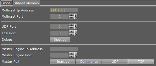

To Use TCP for SHM
Go to the Configuring Viz.
Click on Communication.
Click on the Shared Memory Properties tab.
In the Shared Memory panel set these parameters:
TCP Port: Vizrt does not recommend a specific port. Always make sure that the selected port is not in use by any other program on the same subnet.
Click Save.

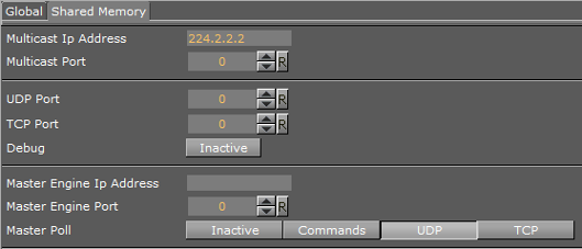

To Use UDP for SHM
UDP Port: Vizrt does not recommend a specific port. Always make sure that the selected port is not in use by any other program on the same subnet.
Click Save.
