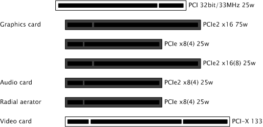

HP ML350p Gen8
This section describes how to setup a HP ML350p Gen8 machine with the different cards provided by Vizrt:
To Setup an HP ML350p Gen8 with a DVS board
PCI-X, PCI slots, HP ML350p Gen8
IMPORTANT! Before touching any components make sure you use an anti-static wrist strap to prevent electrostatic discharge.
Disconnect the power and all other peripherals.
Install the video board in slot 1.
Install the graphic card in slot 6.
Note: Make sure that the cable connections are correctly mounted and that they stay clear of any supplemental aerators or the aerator of the graphics device.
Tidy up all cables and close the computer case.
Note: Placement of cards are the same for both DVS Atomix HDMI (see Digital Video Systems) and DVS Centaurus II

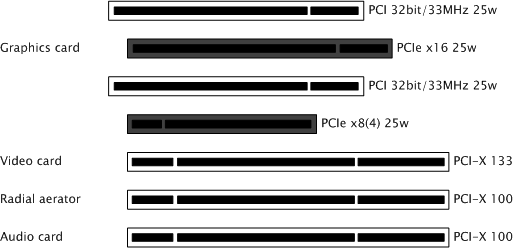

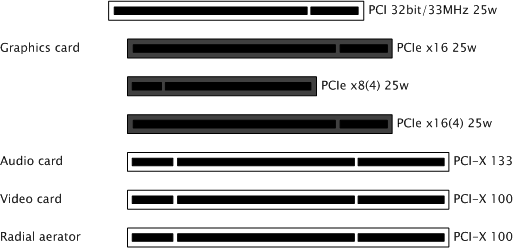

To Setup an HP ML350p Gen8 with a Matrox board
Insert the video board in slot 1.
Insert graphic card 1 in slot 6.
Insert graphic card 2 in slot 8.
Insert the Matrox audio board in slot 3.
Insert the radial-aerator in slot 2.
IMPORTANT! A radial-aerator is mandatory as the video board reaches high temperatures during operation.
Insert the slot panel (x2) for the X.mio2/44 board in slot 4. Connect it to the X.mio2 board.
Tidy up all cables and close the computer’s casing.
Start the machine.
Once the machine is powered up, check that the Matrox X.mio board has been correctly installed. Check that the blue OB-light on the (top) backside of the slot panel is set to ON. If the LED is ON the board is correctly supplied with power.

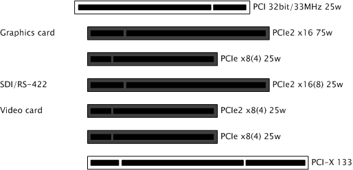

To Setup an HP Z420 with a DVS board
PCI-X, PCI and AGP slots, HP Z420
Install the video board in slot 22.
Install the graphics card in slot 20.
Install the video board two extension boards:
SDI/RS-422 panel in slot 19
BNC panel in slot 23

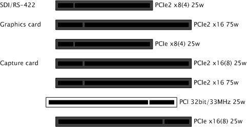

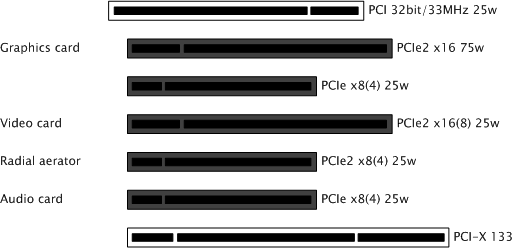

To Setup an HP Z420 with a Matrox board
PCI and PCIe slots, HP Z420
Insert the graphics card in slot 20.
Insert the Matrox video board in slot 22.
Insert the radial-aerator in slot 23.
Optional: Insert the Matrox video board in slot 19.
Optional: Insert the extra slot panel for the X.mio2/44 board in any of the vacant slots, and connect it to the X.mio2 board.
Start the machine.The Matrox X.mio2+ gets very hot in the HP Z420. Make sure that the HP Z420 Fan and Front Card Guide Kit is installed, and set the fan speed to the highest value in BIOS (Power -> Thermal).

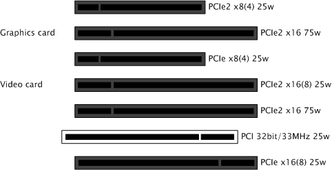

To Setup an HP Z800 with a BlueFish444 Epoch board
PCI-X, PCI and AGP slots, HP Z800
Insert the graphics card in the PCIe slot number 2 from the top.
Insert the BlueFish444 video board in the PCIe slot number 4 from the top.
Note: If you are using the BNC adaptor with the Epoch|2K Horizon board it can be placed directly adjacent the video board on either side.

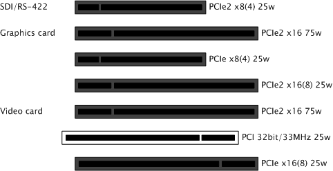

To Setup an HP Z800 with a DVS board
Install the video board in slot number 5 from the top.
Install the graphics card in slot number 2 from the top.
Install the separate SDI/RS-422 panel in slot number 1 from the top.
Make sure that the cable connections are properly mounted and that it stays clear of any supplemental aerators or the aerator of the graphics device.
Note: Placement of cards are the same for both Digital Video Systems and DVS Centaurus II

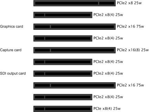

To Setup an HP Z800 with two graphics cards
PCI and PCIe slots, HP Z800
Insert the weaker graphics card in PCIe2 slot number 2 from the top.
Insert the stronger graphics card in PCIe2 slot number 5 from the top.
Insert the Matrox video board in the PCIe2 slot number 4 from the top.
Insert the radial-aerator into the PCIe slot number 3 from the top.
Optional: Insert the Matrox video board into the PCIe2 slot number 1 from the top.
Connect the computer’s monitor to the graphics card in slot 2 from the top.
Start the machine and in the BIOS (Advanced: Thermal – Full Fan speed) set all fans to run at full speed.
Boot and log on to the machine.
Install NVIDIA and Matrox drivers.
Open the NVIDIA Control Panel, and click on System Information in the bottom left corner and check that both graphics cards are installed and run at PCIe x16 speed.
Open Matrox X.info from the system tray and check that the video board runs at PCIe x8 speed.
Once the machine is powered up you may verify that the Matrox X.mio board has been correctly installed by looking for the blue OB-light on the (top) backside of the slot panel. A lit light indicates that the board is correctly supplied with power.

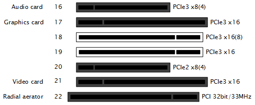

To Setup an HP Z820 with a Matrox board
PCI and PCIe slots, HP Z820
Insert the graphics card in slot 17.
Insert the Matrox video board in slot 21.
Insert the radial-aerator in slot 22.
IMPORTANT! The Matrox video boards can reach very high temperatures when in operation. If a Xmio.2 board is used, a radial-aerator must be installed. If a Xmio.2 Plus board is used a radial-aerator can not, physically, be installed. In this case the chassis fan speed (in BIOS) must be set to maximum to achieve sufficient cooling.
Optional: Insert the in slot 16.

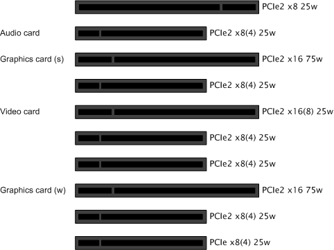

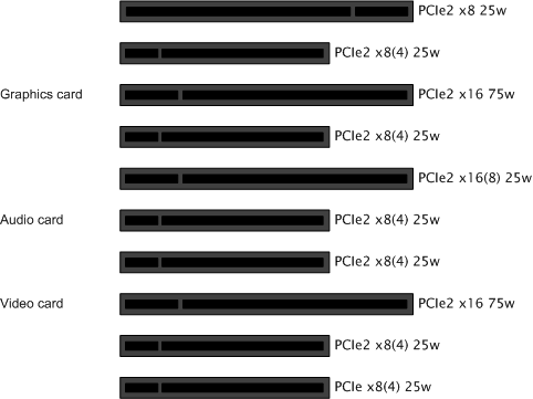

Insert the weaker graphics card in PCIe2 slot number 3 from the left.
Insert the stronger graphics card in PCIe2 slot number 8 from the left.
Insert the video board (i.e. Matrox X.mio2) in the PCIe2 slot number 6 from the left.
If you have a Matrox board, insert the radial-aerator into the PCIe slot number 5 from the left.
Optional: Insert the Matrox video board into the PCIe2 slot number 9 from the left.
Connect the computer’s monitor to the graphics card in slot 3 from the left.
Install NVIDIA and Video board drivers.
If you installed a Matrox board, open Matrox X.info from the system tray and check that the video board runs at PCIe x8 speed.
Note: Matrox DSX.LE cannot be mounted in the DL370 G6
To Setup an HP DL370 G6 with a capture card
PCI and PCIe slots, HP DL370 G6
Insert the graphics card in PCIe2 slot number 8 from the left.
Insert the capture card in PCIe2 slot number 6 from the left.
Insert the SDI output board in the PCIe2 slot number 4 from the left.

To Setup an HP xw8200
PCI, PCIe and PCI-X slots, HP xw8200
Insert the Matrox video board into the PCI-X slot number 4 from the top.
Insert a powerful radial-aerator into the PCI-X slot number 6 from the top.
Optional: Insert the Matrox video board into the PCI slot number 7 from the top.
Note: A radial-aerator is mandatory as the video board reaches high temperatures during operation.
HP xw8400
This section describes how to setup a HP xw8400 machine with the different cards provided by Vizrt.
To Setup an HP xw8400
SATA plug, HP xw8400
Before mounting the video board, the SATA connector originally connected to the SATA port 0 needs to be reconnected to SATA port 1 to make room for the video board.
Note: For an HP xw8400, the X.mio24/6000 video boarInsert the Matrox video board into the PCI-X slot number 6d requires a 64-bit PCI-X slot operating at a minimum of 100 MHz.
from the top.
Insert a powerful radial-aerator into the PCI-X slot number 7 from the top.
Optional: Insert the Matrox video board into the PCI-X slot number 5 from the top.
