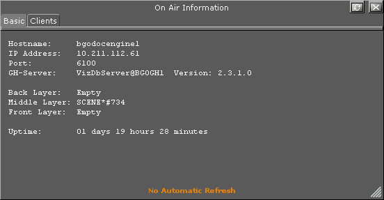

Basic Tab
In the Basic tab, the parameters required to send external control commands are shown:
Refresh button: Refreshes the status information.
Hostname: Shows the name external control programs can use to communicate with Viz Artist.
IP Address: Shows the IP address external control commands can communicate with Viz Artist.
Port: Shows the port Viz Artist is using. Default port is 6100, but may be changed in Viz Config’s Communication section.
GH-Server: Shows the Graphic Hub Manager server Viz Artist is connected to.
Back Layer: Shows the name of the scene that is defined to run in the background of the middle and front layer scene(s).
Middle Layer: Shows the name of the scene that is defined to run in the middle between the back and front layer scene(s).
Front Layer: Shows the name of the scene that is defined to run in the foreground of the back and middle layer scene(s).
Uptime: Shows the time elapsed since Viz was started.

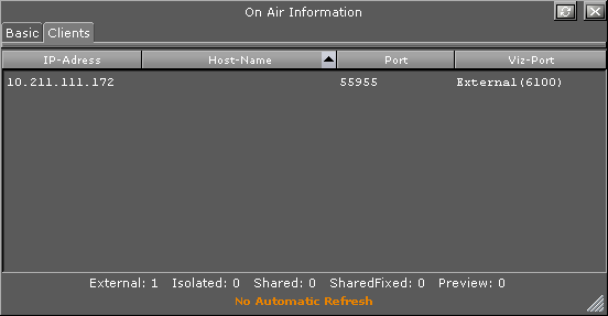

Clients Tab
In the Clients tab, all connected clients are shown with the IP address, host name and Viz Port.
