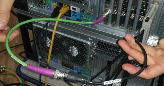

Make sure the NVIDIA G-SYNC card receives the same reference signal as the video board:
If a Matrox X.mio2 video board is in use, the loop through of the reference signal can be used, as illustrated below:

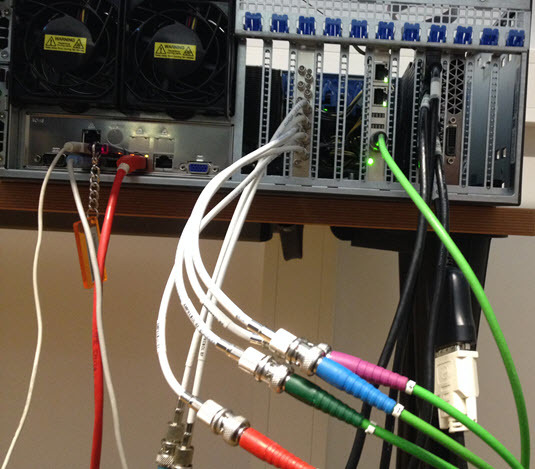

Connect the NVIDIA G-Sync and Matrox X.Mio3 to the Genlock source.
When attaching the connector cables between the graphics card and the G-SYNC card, make sure that the red line on all of the connector cables are facing the card’s mounting bracket, towards the back of the case. Failure to do so can result in synchronization issues. -
Connect the Matrox X.Mio3 video input and output jacks.

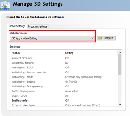

Using the standard NVIDIA settings for Viz Engine, change the following parameter:
Vertical Sync:On.
Apply the changes, then select 3D App - Video Editing from the profile drop-down menu, and apply changes again:

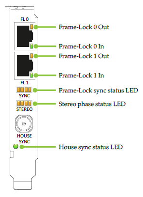

To Check the Status LEDs of the G-Sync Device
Ensure the House sync status LED indicates that a proper sync signal is connected.
Ensure that the Frame-Lock sync status LED is shining green. It must not blink or shine orange. When sync is stable, the Stereo phase status LED should also be lit green.
