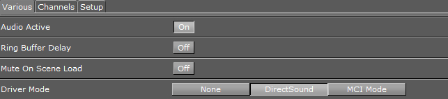

Various Tab
Audio Active: This acts as a global on/off switch for audio in the Viz Engine.
Ring Buffer Delay: Enable to make the audio system compensate for the ring buffer delay during clip playout. Ring buffer is ignored when disabled.
Mute On Scene Load: When set to On, audio is muted before any scene load commands are executed. This is necessary for video cards which do not mute the audio automatically, when no video refresh happens.
Note: Additional commands to mute audio can be added in the Viz Config file.
Driver Mode: Affects playback of sound on the computer running Viz Engine, for audio monitoring purposes.
None: Prohibits Viz Engine from playing out sound on the local system.
DirectSound: Use DirectSound drivers (requires DirectX). This is the recommended driver.
MCI Mode: Use MCI driver mode, for systems where DirectSound is either not available or performs unsatisfactorily.

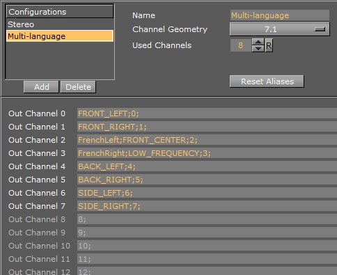

Channels Tab
Configurations: Shows a list of channel configurations.
Add: Adds a new channel configuration to the Configurations list.
Delete: Deletes the selected channel configuration from the Configurations list.
Name: Set the name of the selected channel configuration.
Channel Geometry: Sets the channel geometry. Options are:
Mono
Stereo
5.1
7.1
Quad
Used Channels: Set the number of configurable channel alias fields that can be mixed by the internal channels in Viz Engine (software). On a Matrox system this number must be equal to the number of configured input channels (hardware). This setting is independent of the Channel Geometry setting.
Reset Aliases: Set the channel aliases to the default option (the custom entry is not removed)
Out Channel 0-15: The Out Channels represent the internal Viz audio channels, which are mixed to the output device one by one. Alias names are useful to create multilingual systems, and also to define the channel geometry for the Default and FX audio clip mix modes. Aliases are separated by a semicolon. The Audio plug-in only uses the channel aliases to find the correct speakers for Pan and 3D sound effects in FX mode. With this functionality any of the 16 internal audio channels can be used to play any audio geometry.

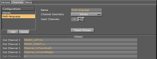

To Add Multi-language Audio Channels
From the Channels tab, click Add.
Select the new entry from the Configurations list
Enter the new name in the Name field.
Set the Channel Geometry to Stereo.
Click Reset Aliases.
Set the number of Used Channels to 4.
This will improve the performance.
In the Channel 2 field, add the alias FrenchLeft.
In the Channel 3 field, add the alias FrenchRight.
Add the same configuration for English (EnglishLeft, EnglishRight) and German (GermanLeft, GermanRight) on the other machines.
Click Save.

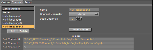

To Add Multiple Audio Channel Configurations
Repeat To Add Multi-language Audio Channels to add three more Multi-language Audio Channels.
Name the configurations the following way:-
Multi-languageF
Multi-languageE
Multi-languageG
Add a Multi-languageAll configuration.
In the Channel 1 field, add the aliases FrenchLeft, EnglishLeft and GermanLeft, then do the same for Channel 2.
FRONT_LEFT;Channel_0;FrenchLeft;EnglishLeft;GermanLeft;FRONT_RIGHT;Channel_0;FrenchRight;EnglishRight;GermanRight; -
Click Save.

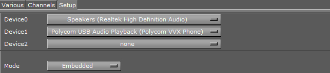

Setup Tab
The Setup tab lists all available audio devices available to the Viz Engine audio mixer (see Audio in Viz).
All devices listed with Device0 are DirectSound compatible devices installed on the system. Device0 is always the default playback device, configurable through Sound options in the Windows system Control Panel.
When a Matrox card is installed, Matrox audio is available.
With Matrox audio, there are different ways to capture audio for use with the Viz Engine audio mixer, before it is output:
Capture audio embedded in the live video input signal from the live input connectors.
Capture audio from the AES connectors.
The final output is the same, either embedded as part of the live video output signal, or separated out to the AES output connectors.
In addition, simply loop audio through the system. This will make the embedded or AES audio unavailable to the Viz Engine audio mixer.
The Default mode captures audio and directs it to the default onboard audio device with no output on the Matrox card output connectors.
Note: The Matrox audio-extension board is not configurable through this user interface.
Device n: Shows the name of the audio card.
Mode: Refers to the audio mode of the Matrox board. Options are:
Embedded: Audio is captured from the Live video input connectors and made available to the Viz Engine audio mixer, to mix it with other audio sources. Then output as embedded audio on the live video output connectors.
AES: Audio is captured from the AES input connectors and made available to the Viz Engine audio mixer, to mix it with other audio sources. Then output on the AES output connectors.
Embedded -> AES: Embedded audio is captured from the live video input connectors and made available to the Viz Engine audio mixer, to mix it with other audio sources. Then output on the AES output connectors.
AES -> Embedded: Audio is captured from the AES input connectors and made available to the Viz Engine audio mixer, to mix it with other audio sources.Then output as embedded audio on the live video output connectors.
Loop: Audio is looped through. No audio is mixed.
Default: Audio is captured, but no output on the Matrox card.
