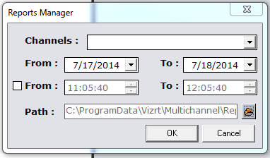

Create a Report based on Multiple Channels and Playlists
Select Tools from the main menu, and then Reports Manager.
From the Channels combo-box, select all the channels to run the report on.
Select the From and To dates to run the report on.
If desired, enable the From and To times with the check box, and select the times to run the report on.
Select the Path where the text file report will be saved. The default path used is %ProgramData%/Vizrt/Multichannel/Reports (i.e. normally C:\ProgramData\Vizrt/Multichannel/Reports) but if required you can select another location to use.
Click OK.
The result will look like the report below:
