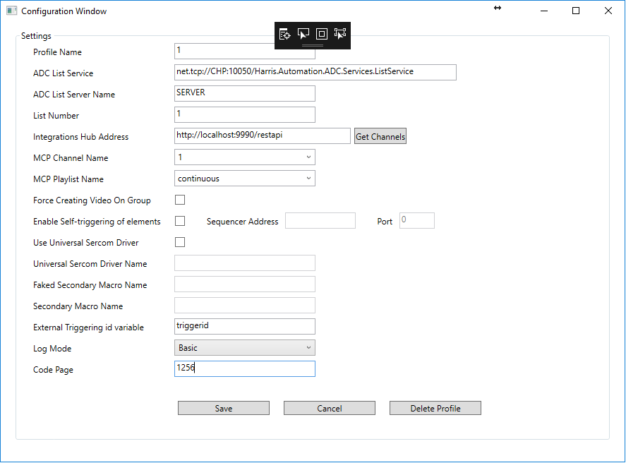

Configuration and Startup
To start and configure the integration module for Harris, click the Windows Start menu and open the program by browsing to All Programs > Vizrt > Viz Multichannel > Viz Multichannel - Harris Integration.
The Harris integration module will display the Configuration window:
Detail |
Description |
Profile Name |
You can have multiple settings profiles. If you run multiple instances of the Harris Integrations service, it is recommended to make configuration changes from one instance only to avoid overwriting configuration changes. |
ADC List Service |
Address of the ADC List. Change the IP as required. Ask your Harris system administrators for the correct address. |
ADC List Server Name |
The ADC List Server name that should be used in the integration. |
List Number |
Sequence of list that should be used in the integration. Example: If the actual Harris system has three list-names called "Playlist 1", "Playlist 2", "Playlist 3" and you want to use "Playlist 2" for the integration, specify 2 as the list-number. |
Integrations Hub Address |
Specify the URL of the REST service. Note: You can browse to this URL with a browser to check that the Integrations Hub is installed and working. Expected result answer is: Integrations Hub. |
MCP Channel Name |
The channel name you have defined in Multichannel that should be used with this direct integration module. |
MCP Playlist Name |
The name of the playlist you want to sync data with. The format of playlist name is [dd_MM_yyyy] and you can also input "continuous" or "running_playlist". Use the playlist name running_playlist to sync data with the current running playlist. |
Force Creating Video On Group |
Enable the application to use Media Name to search for videos in Viz One and add to an event. For this feature to work, integration with Viz One must be enabled in Multichannel. |
Use Universal Sercom Driver Name |
If checked, Harris Integration will activate the Universal Sercom Driver Name and this Macro Name will also be activated in the process. |
This ID must match the ID column in Harris Automation. Ask your Harris administrator for the driver name ID. |
Faked Secondary Macro Name |
Define the macro used here in order to use a secondary event to re-label the Primary event's trigger ID. |
Prefix of page-name information from Harris Automation, related to Macro definition in Harris system. The value can be semi-colon (';') separated and contain multiple values. |
Log Mode |
Enable or Disable log messages. Verbosity can be specified as Off (no logs), Basic or Full. The Log and Error Log files will normally be located in %ProgramData%\Vizrt\Multichannel\HarrisIntegration. You can also open the log directories in Windows Explorer by pressing Show log folder or Show error folder. |
Code Page |
The Description and CompileId fields returned from the Harris system are converted according to this defined code page. |
When all the appropriate setting are configured press Save.
Press START.
