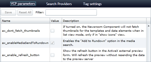

Database Parameters
In the VCP Parameters tab the user can configure settings for the Viz Pilot system’s applications. A description of useful database parameters is listed here.
To give applications access to the Pilot Data Server
To give applications access to the Preview Server
To give applications access to the Update Service
To set the Database Parameters for the Crop Service
To enable the built-in Object Store search
To configure Order Management
Click the Settings link
Select the app_server setting, and add the parameter for the machine you installed the Pilot Data Server on (i.e. <DataServer>:8177)
Click Save
This will give all applications with a connection to the database access to the Pilot Data Server.
IMPORTANT! Firewalls must allow inbound communications on port 8177.
Select the preview_server_uri setting, and add the parameter for the machine you installed the Preview Server on (i.e. http://<hostname>:54000)
• This machine, with Viz Engine and Preview Server installed, is typically identified as your frame server. -
Click Save
This will give all applications with a connection to the database access to the Preview Server.
Select the script_runner_uri setting, and add the parameter for the machine running the Update Service (e.g. http://<hostname>:1981)
• This setting is needed if templates run scripts that use the update service -
Click Save
This will give all applications with a connection to the database access to Script Runner.
IMPORTANT! If you change the script_runner_uri parameter (after setting it the first time) you need to restart the Media Sequencer for it to take effect.
Select the crop_service_uri setting, and add the parameter for the machine you installed the Pilot Data Server on:
• http://<cropservicehostname>:8178 / -
Optional: Set the MediaSearch_ItemPerPage = Number of items per page to get from MediaSearch.
Optional: Set the croptool_max_image_area to adjust the maximum size of a cropped image that will be served by the Pilot Data Server.
If the image size (*) is larger than croptool_max_image_area, then the image will be resized, while still respecting the aspect ratio of the crop. The maximum image size applies even if no cropping is done.
* Image size = image width x height in pixels. -
Click Save
The built-in Object Store search is turned off by default. To enable or disable it:
Select the disable_built_in_vos_search setting,
• To use built-in Object Store search, set disable_built_in_vos_search to false
• To use RestVOS search, set disable_built_in_vos_search to true -
Click Save
This procedure assumes that you have a Viz One system installed and running the Order Management system. For more information on how to configure order management on Viz One, see the section on ‘Tasks and Order Management’ in the Viz One Administrator’s Guide.
Select the order_mgt_uri_template setting, and add the address of the Viz One machine which is hosting the order management system, eg:
http://<fully-qualified-domain-name-of-viz-one>:8084/tasks/?user={user}&locale=en_US&theme=light#create;tl=work_order;form=create_wo_activex;asset-type=ITEM;upload=true;external-hooks=viznewsroom;closewin=false;set-attr=REQ_TYPE-{asset_type}

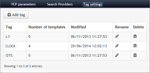

Tag Settings
The Tag Settings page is used for administering tags. The tags are assigned to templates in Template Wizard, and then used in Viz Pilot News to organize templates.
To access the Tag settings
See how To access the Pilot Data Server Web Interface
Click the Tag settings link
Tag Settings functions
Function |
Description |
Add tag |
Click the Add Tag button and enter a name for the new tag. |
Click the Rename icon to rename the selected tag |
Click the Delete icon to delete the selected tag. Note: Deleting a tag will not delete the templates that refer to that tag. |
