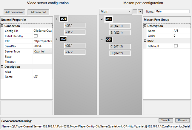

From the Mosart Device Properties menu, select the Video Servers tab, to display the configuration menu below.
The left side presents details of the physical servers, and any port configurations.
The example above presents a Quantel server, sQ1 (as selected from the Server Type drop-down menu), and one other server (sQ2), which could also be a Quantel server.
Server sQ1 has 2 ports defined, sQ1:1 + sQ1:2.
Server sQ2 has 2 ports defined, sQ2:1 + sQ2:2. -
The right side presents details of the virtual connection within Viz Mosart, with salvo definitions.
This is described in Working with Mosart Port Configuration.

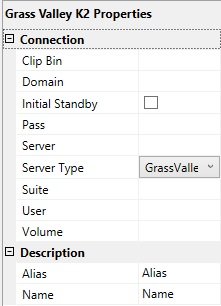

Grass Valley K2
Connection to K2 is initialized with a ping (ICMP) from Mosart to the server to confirm the connection. Then it uses port 3811 to communicate with the K2 server. Both must be open for Mosart to be able to connect.
Manus Admin uses a separate port when it connects: 49171 (a range is OK. Use 49168-49172)
Clip Bin: This value, together with that of Volume (see below), defines the default server location of clips to be played. This default location is used only when the location is not provided by other means. (In particular, it is not used when the setting IgnoreBin (in Media Administrator) is true for this server.) The value of Clip Bin should designate a bin in the volume designated by the value of the Volume setting.
Domain: The domain as part of the user credentials.
Pass: The password as part of the user credentials.
Suite: Arbitrary value. However, follow these guidelines:
For each K2 server, two or even three unique Suite values must be used:
First, the values for Media Administrator and AV Automation must be different.
Second, in a redundancy setup with Main and Backup Mosart server, the two values for Media Administrator must be different.
Note: In this constellation,
(Whereas both Main and Backup AV Automation should use the same value, different from the two Media Administrator values.)
User: The username as part of the user credentials.
Volume: This value, together with that of Clip Bin (see above), defines the default server location of clips to be played. This default location is used only when the location is not provided by other means. (In particular, it is not used when the setting IgnoreBin (in Media Administrator) is true for this server.) The value of Volume should designate a server volume.

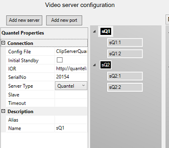

Quantel
Config File: The path to the XML configuration file used to define the Viz Mosart - Quantel communication.
IOR: The HTTP link including hostname or IP address to the IOR resource on the Quantel ISA manager. Example: http://192.168.100.50:2096/ZoneManager.ior
SerialNo: The serial number of the Quantel playout server.
Slave: The hostname or IP address of the slave/backup IOR.
Timeout: Timeout value for requests from Viz Mosart to ISA manager. If the request exceeds this timeout the server connection is reinitialized. Setting a value here should only be needed for sites experiencing issues with the Quantel connections. Leaving a blank value uses the default timeout.

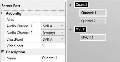

Video Server Port Properties
Alias
Audio Channel 1: The audio channel 1 for the selected video port.
Audio Channel 2: The audio channel 2 for the selected video port.
CrossPoint: The video crosspoint for the selected video port.
Video port: The actual port name/number on the video server. Please refer to the documentation of your video server for information on how to find these.
Name

To Add a Server
Click the Add new server button
In the Properties pane on the left, select the Server Type and add additional information such as Port and Server host.
To Remove a Server
In the Video Server Configuration tree, right-click a server node and select Remove.
To Add a Port
In the Video Server Configuration tree, select a server node
Click the Add new port button, or right-click the server node and select Add new port
In the property editor on the left, enter the port information.
To Remove a Port
In the Video Server Configuration tree, right-click a port node and select Remove.

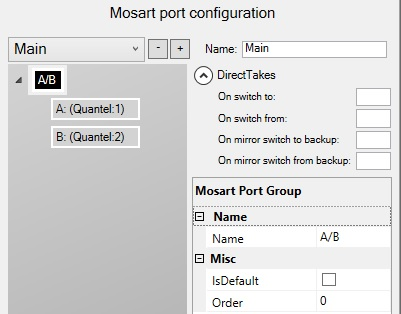

Direct Takes
On switch to: The Recall Nr (see Template Properties) of the direct take template that should be taken when switching to this virtual server salvo.
On switch from: The Recall Nr of the direct take template that should be taken when switching from this virtual server salvo.
On mirror switch to backup: The Recall Nr of the direct take template that should be taken when switching to a backup server using this virtual server salvo.
On mirror switch from backup: The Recall Nr of the direct take template that should be taken when switching from a backup server using this virtual server salvo.

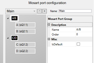

Mosart Port Group
Name: The name of the virtual server group. This name is displayed in the server part of the templates.
IsDefault: Enable to set the default and preferred video port group for assets residing on multiple systems.
Order: See the documentation of the Media Router. If the Media Router is not used, this value can be left to the default 0.

To Add a Virtual Port Group
Right-click in the Mosart Port Configuration tree (not on a node) and select either:
Add virtual ripple group to add a new virtual ripple group. The default ripple group names are A/B, C/D, E/F etc.
Add virtual preview group to add a new green virtual preview group node to be used for preview ports. The default preview group name is P.
Add virtual recording group to add a new red virtual recording group node to be used for recording ports. The default recording group name is Rec .
You can edit or rename the selected group using the Properties Editor on the right.

To Connect a Server Port to a Virtual Port
You can connect a server port to a virtual port:
Select the server port (in the left-hand, Video server configuration part) you want to connect, and drag it to the virtual port (in the right-hand Mosart port configuration part) that you use to represent the port in the selected salvo.
Note: If the virtual port is a recording port (in the recording group), the server port to connect must also be a recording port: The physical server must have recording capabilities (and the chosen Server Type must allow for recording).
To connect two server ports to one virtual port, causing mirroring:
Select a server port and drag it to the virtual port that you use to represent the port in the selected salvo.
Select another server port and drag it to the same virtual port.
Note: Only two ports can be mirrored.
