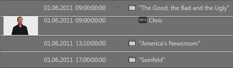

Add Video Clips to the Playlist
images/download/attachments/58345768/scheduling_clip-secondary-event.png
  1. Select your channel.
  2. Click the Playlists button and open your playlist.
  3. Click the Video Clips button.
  4. Search for a video.
  5. Drag and drop your video placing it as a secondary event.
  6. Double-click the video to preview it in the Timeline Editor.

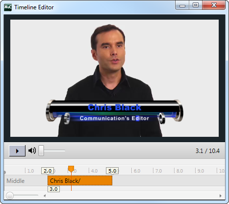

Add Graphics to Video Clips
    images/download/attachments/58345768/scheduling_playlist-video-graphics.png
  3. Add a video clip as a secondary event (see Add Video Clips to the Playlist).
  4. Add a page to the video clip (see Manually Add a Page to the Playlist). This adds the page as a sub element of the video clip, grouping them together. If the page does not have a default duration set, you can set this by editing the page’s Duration column.
    images/download/thumbnails/58345768/scheduling_video-timeline-editor-w-graphics.png
  5. Double-click the video clip to open the Timeline Editor. This lets you adjust the offset and duration of the graphics.

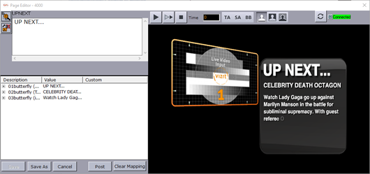

Add Video Clips to Graphics
images/download/attachments/58345768/scheduling_pageeditor-video-gfx.png
  2. Click the Templates, Pages and Pilot Data Elements button.
  3. Open your template or page to open the Page Editor.
  4. Select the tab field that will hold the video. This opens the video search frame.
  5. Search for and select (for example double-click) a video. If the clip channel is set to automatically play the video you should be able to see a low-resolution version of the video.
  6. Click Save As and enter a new page name.
