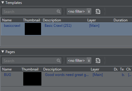

In the Templates and Pages panel, you can view all imported templates and pages based on those templates. You can also filter your templates and pages view and add content to pages using the Page Content Filling Window.

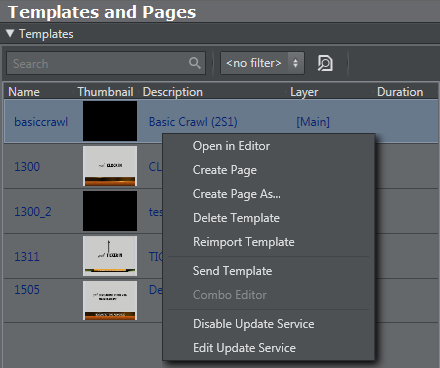

Template Context Menu
Right-clicking a template opens the context menu:
  • Open in Editor: Opens the template editor which allows you to create a new page based on the template.
  • Create Page: Creates a page based on the selected template. The page can be opened in the template editor for editing.
  • Delete Template: Deletes the selected template/data.
  • Reimport Template: Scans the scene and re-imports the selected template. The resulting object will be recreated. When re-importing, you will first be asked to confirm and the following reminder will  then appear: existing pages description might not reflect the true data content until refreshed by update.
  • Add To Favorites: Adds the template to your pre-defined Favorites filter.
  • Send Template: Sends the selected template(s) to the master control room. This option is only enabled if the Remote Host is defined in the General Settings.
  • Combo Editor: Opens the Combo (short for Combination) template editor where you can change templates based on multiple Transition Logic (TL) scenes. For more detailed information, see the Combo Page Editor section.
  • Enable Update Service: Enables you to assign an update service for the selected template.
  • Disable Update Service: Disables the update service for the selected template.

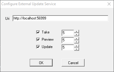

  • Edit Update Service: Edit the update service for the selected template by setting the service URL. A timeout on the available commands (take, preview and update) may be set as well. This will delay the given command sent by the Media Sequencer to the Viz Engine.

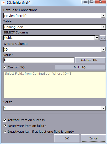

Database Connection Window
  • Database Connection: Allows you to select from your list of pre-configured Database Connections.
  • Table: Allows you to select a table from your selected database.
  • SELECT Columns: Allows you to select a column from your selected table.
  • WHERE Column: Allows you to select a location from which the value should be selected.
  • Value: Allows you to set which value is selected from the WHERE column.
  • Relative Attr...(button): Allows you to select a relative attribute from the Page Content Filling Window.
  • Custom SQL: Allows you to write a custom SQL query with multiple dynamic mappings (for example, Select Field1 from ComingSoon Where Field4=’PG-13’ AND Field2=’23.12.2013’).
  • Build SQL (button): Builds the query based on your previous selections.
  • Set to: Allows you to select which page field that is updated by the query. Ensure that the SELECT columns match the page fields.
  • Activate item on success: Ensures that playlist items will be marked as active if the query is successful and data fields have been populated. Leave this unchecked if you do not want the success of the query to affect the status of a playlist item.
  • Inactivate item on failure: Ensures that playlist items will be marked as inactive if the query fails and data fields have not been populated. Leave this unchecked if you do not want the success of the query to affect the status of a playlist item.
  • Deactivate item if at least one field is empty: Ensures that playlist items will be marked as inactive when one of the fields the query returns is empty. Leave this unchecked if you do not want the success of the query to affect the status of a playlist item.
