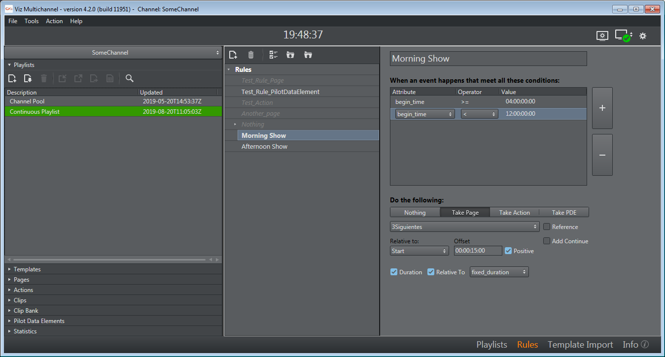

-     Select Rules from the menu actions to bring up the user interface for working with rules:
-     In the screenshot above, there are now two window panes on the right-hand side:
 In the left pane, you can create, delete, activate/deactivate, select and import/export rules.
 In the right pane, you can work with a selected rule: name the rule and give it the appropriate conditions and actions.

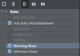

Select by clicking the rule you want to work with, or select the appropriate icon to create, delete, activate/deactivate or import/export rules.

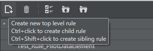

Rules can be grouped into a hierarchy with children and siblings. Hover the cursor over the create rule icon to see the options: CTRL + click to create a child rule and CTRL + SHIFT + click to create a sibling rule:

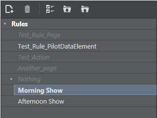

Existing rules can be activated/deactivated as required. In the example below for example the rule Another_page is deactivated while Morning_Show are activated.
The Import/Export of rules is from/to XML-files. Since existing rules will be overwritten when importing rules, make sure you want to overwrite, or create a copy safely stored to disk as backup, before importing.

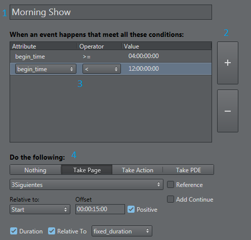

Once you have selected a rule, you can use the rules panel to create conditions and actions for the rule:
Referring to the screen-shot above:
-     Name the rule (if newly created).
-     Create or delete conditions. You can have as many conditions as needed. Conditions are expressions that specify if the rule should be applied. Using the various condition operators you can answer questions such as: if the next film is for the ages over 12, display a legal-age page as graphics 10 seconds into the film.
-     Define the conditions of the rule. A rule is only applied if all the criteria in the conditions are met. Click the column Attribute, Operator or Value to select possible values from a dropdown-list or to change the actual Value. Condition types are explained in more detail in the next section, Rules criteria and conditions.

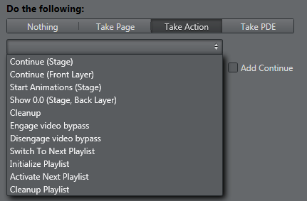

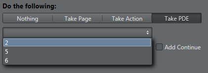

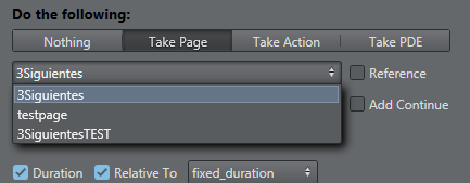

-     If all conditions for the rule are met, the rule will be acted upon and you can specify what should happen: do Nothing, insert a specific Page, a predefined Action or a Pilot Data Element. Clicking on the Page, Action or Pilot Data Element button will enable a dropdown list where you can select the appropriate element as shown in the screenshots below:
 Take Page
 Take Action
 Take PDE (Pilot Data Element)
Modifiers / checkbox selectors in the Rules UI panel:
-     Select the Reference checkbox to allow page/action to be added as a referenced page/action.
-     Select the Add Continue checkbox to add Continue action after the event added by rules. This option lets you set the offset time for the continue action.
-     Relative to: the starting reference point for time calculations, example: Start or End.
-     Offset: The offset from the selected reference point.
-     Positive: if selected, the offset is positive from the reference point.
-     Duration: Duration for the action. If no duration is set, the call-back will be the origin page.
