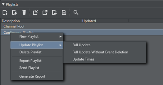

Right-clicking on a playlist in the left pane displays a context menu of playlist commands:
-     Update Playlist: allows you to select one of the following update options: -     Full Update: updates the entire playlist, primary and secondary events.
-     Full Update Without Event Deletion: updates the entire playlist, primary and secondary events; however, it will not delete events that have already been added.
-     Update Times: Allows you to only update the event times according to the imported schedule.
-     Delete Playlist: Deletes the playlist.
-     Export Playlist: Exports the playlist to a native Viz Multichannel XML format. You can also export the Graphics and Data as part of the export.
-     Send Playlist: Sends the playlist to the master control room.
-     Generate Report: Generates an HTML report of the selected playlist.

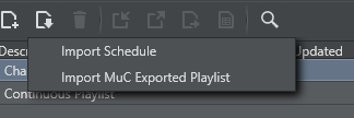

Import a MuC Exported Playlist
A playlist that has previously been exported from MuC as an XML file can be imported back using the Import MuC Exported Playlist menu item.
This will import the XML playlist to MuC without performing any mapping settings. Playlist data is set as it appears in the imported file.
If the contained broadcast date already exists, the imported data will not replace the existing playlist. You must first delete the existing playlist.
-     Click the Import icon and select Import MuC Exported Playlist

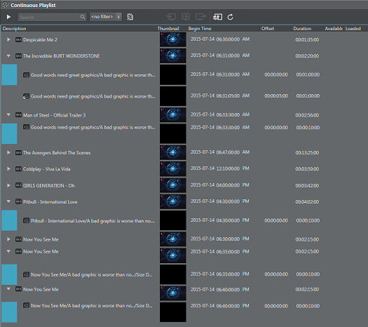

Playlist Columns
When the right pane displays the playlist, all events along with pages and actions scheduled together are displayed.
To edit the playlist columns you must check the Edit Events check-box in your mapping table (see Table Columns) for each column.
Right pane showing playlist
The layout and visibility of the playlist columns can be customized by drag-and-drop and by right-clicking one of the columns to select or de-select them. Secondary events that have been edited will have a color indicator in the left side of the edited row.
Note: If there are any errors found in the playlist, the primary element(s) causing the error will be shown in red. Hover the mouse over the red no-entry icon of the error element(s) for more information.

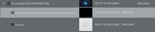

Elements in the playlist that are inactivated will be show with a gray background as illustrated in the screenshot below.
Note: Elements in the Multichannel playlist can be de-activated by external events or applications. For example, by Media Sequencer if the required resources are not available for the element.

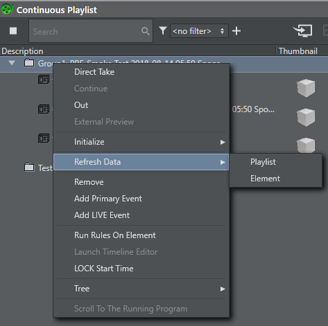

Playlist Context Menu
Right-clicking the playlist opens the following context menu:
-     Direct Take: Takes the playlist element directly to air. If the element is available and/or loaded it will play immediately. If not, the element will be taken on air as soon as it is.
-     Continue: Continues the animation of the graphics if the graphics has a continue point.
-     Out: Takes the element off air (i.e. hard cut).
-     External Preview: Previews the element on your configured preview channel (see section Configuring Device Channels and Configuring Playout Devices).
-     Enable or Disable Element: Only for secondary events. Allows you to either enable or disable a secondary element.
-     Re-try creating page from this element: This menu item will only shown for elements with errors. An example error condition that could trigger this is: A request to create a page is pushed via the Integrations Hub, but the page is not found in the Page Pool at creation time. A stub-version containing meta-information will be created. If the requested page is later created in the Page Pool you can use this menu item on the element and store the page-relevant data under the element.
-     Initialize (see section Playlist Toolbar). -     Playlist: Initializes the entire playlist.
-     Element: Initializes the selected playlist element.
-     Refresh Data: Request a refresh of automatic page content or primary event Viz One metadata, as shown in the screenshot below:
 -     Playlist: Clicking here iterates through the entire playlist and update all elements.
-     Element: Clicking here updates page data or Viz One metadata for the selected element of the playlist only.

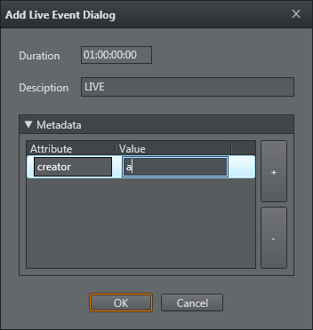

-     Add Live Event: Adds a live event.
