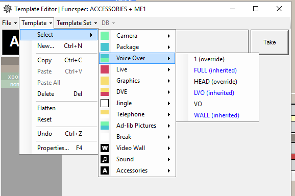

You can see the relationship between a templates inherited from one set to another (created using the hierarchic approach), by selecting properties of the template from the newer set.
Black letters without any parenthesis: Operation is defined in the current template set only
Black letters with (override): Operation is defined in the template set but also exist in the base template set. The current template set definition is used and overrides the implementation in the base
Blue letters with (inherited) : Operation is defined in a base template set and has no implementation in the current template set
Red letters: An empty template, this operation is not defined.

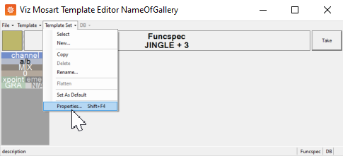

To work with a template set, from the AV Automation utility, select Devices > Template editor, to open the editor.
From here you have several operations:

To Rename a Template Set
Select Template set > Rename .
In the Name field, enter a new name for the set.
Click OK.

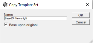

To Copy a Template Set
Referring to the background discussion in Working with Template Sets above, when you copy a template set, it is more efficient to use a hierarchical approach.
Select Template set > Copy.
Enter the name of the new set in the text box.
Hierarchic approach: Select check-box Base on original.
Note: If the Base on original check-box is not selected a physical copy of the entire template set including all nested templates, is created.
Click OK.

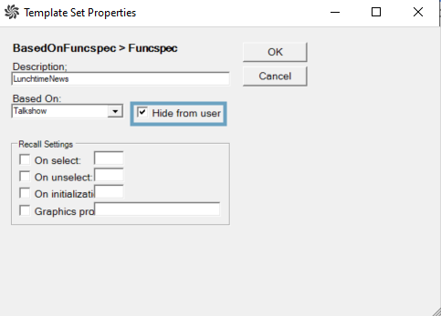

To Hide a Template Set
When a template set is hidden it is unavailable to users of the Viz Mosart GUI and any NCS components (ActiveX) that normally provide user access to select template sets.
Select Template set > Properties .
Select check-box Hide from user.
Click OK.

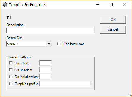

Template Set Properties
You can manage some properties of a template set with Template Set > Properties.
Which displays the configurable parameters:
Item |
Description |
Description |
The name of the template set. |
Based On |
Original template set, upon which this template set is a unique variant. |
Hide from user |
Prevent template set from appearing in user selection menus. |
On select |
Behavior of recall under this condition. |
On unselect |
On initialization |
Graphics profile |
(When used) Profile that will be applied to the new template set. |
