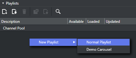

Click the Playlists pool. All existing playlists for the selected channel are displayed.
EITHER Click the New Playlist button (top left). or the context-sensitive menu option (see screenshot).
A new row representing the new playlist is added.

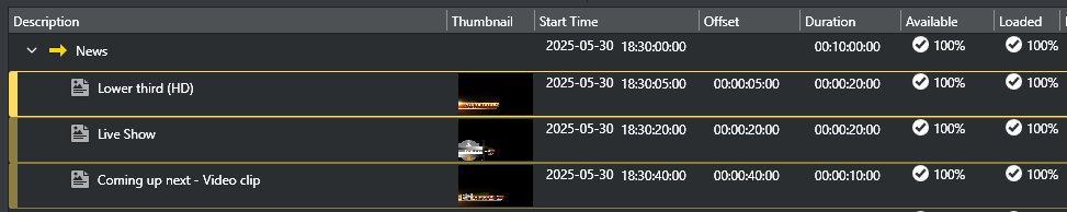

The playlist currently has six states for elements that reside inside the playlist. Each of these states uses a color on the playlist elements to provide a visual indication of their state:

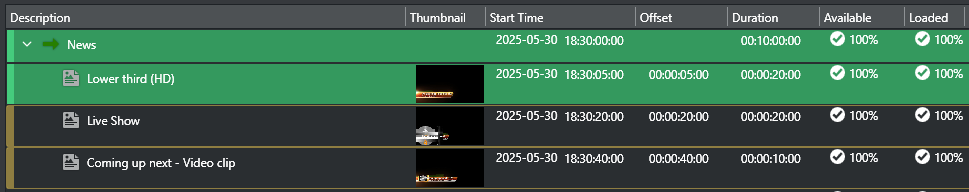

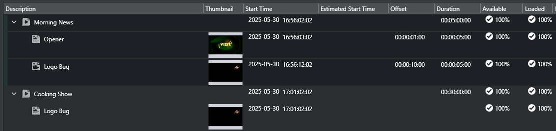

Normal state: The state of an un-played element. Elements are shown in White text.
Played state: The state of an element that has been played out at least once. Elements in are shown With a green status and dark background.
Cue state: The state of an element in a group has been called by MSE, to prepare for playing. These elements are shown in dimmed Yellow status.
Pre-queue state: The state of a next element that will start playing within 5 seconds. Elements are shown with Yellow status.
Playing state: The state of an element that is currently playing. These elements are shown in Green. The cue state of a playlist that is activated by an external trigger has a yellow arrow in front of its element, otherwise the playing state has a green arrow in front. External triggering can be a VDCP-signal from the automation system, for example.

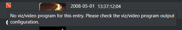

Error state: The state of an element where it has been set incorrectly and cannot be played. Elements in error are shown in Red and will also have a tool-tip indicating what caused the error, if the error condition provides this information, which most errors do.

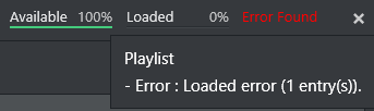

Playlist Errors
Playlist Errors in the playlist will most likely stop the playlist instantly or make the playlist work incorrectly. All indicated errors should therefore be treated as severe. The cause of the error must be investigated and corrective action must be taken to prevent the error from happening again. Errors can occur if the playlist was set incorrectly, if the elements residing in the playlist aren’t created correctly, or as a result of other circumstances. Errors are separated into six groups as shown in the list below. There is one additional error type if the MAM system Viz One is enabled:

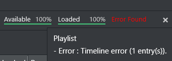

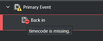

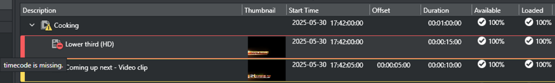

Timeline error:
This error occurs because a timeline in the playlist isn't defined for element(s). To fix this, the user needs to define a timecode for each element correctly such as a begin time, offset, duration, etc. The errors that usually occur for this type are that timecode has already passed, timecode is missing.

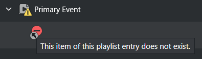

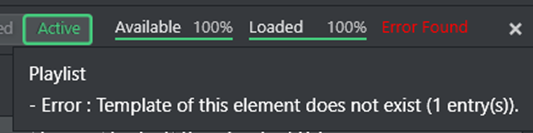

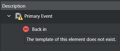

Template does not exist:
This error occurs because the master template of elements inside the playlist is missing.

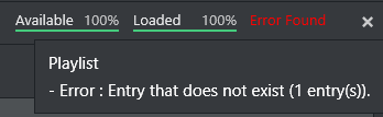

Entry does not exist:
This error occurs because there are some entries missing in any elements inside the playlist. For example, an element created by a page as a reference element then refers to the page. If the page has been removed then this error occurs as it has no entry which it refers to.Available error for playout devices:

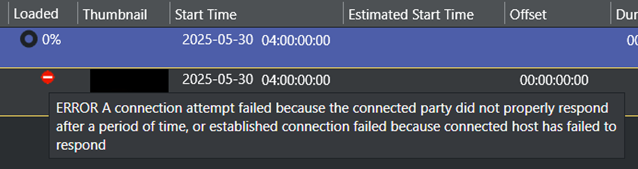

This error occurs when the Playout Configuration isn't set correctly.Loading error:

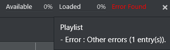

This error occurs when the Playout Device was set with an incorrect host. After that, the client tries to load the scene into Viz Engine by using an initialize command.Other error types:

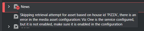

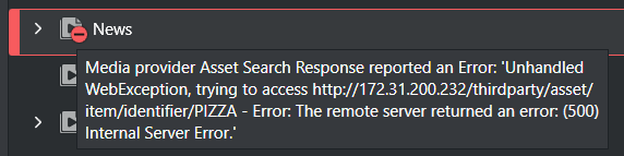

Other errors aren't specific errors. They can occur by any reason which is not related to above cases.Viz One specific errors:

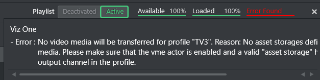

A Viz One Error is an error related to an asset storage. There are specific details on the solution in the tooltip.
This error occurs because of an asset storage isn't defined. To fix this, go to Playout Configuration and click edit at the defined Viz Engines and Video Devices. A configuration form with a drop down box for selecting an Asset Storage will appears.
