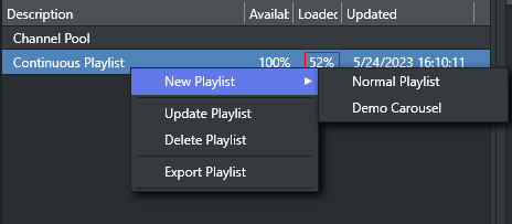

Right-clicking on a playlist in the left pane displays a context menu of playlist commands:
New Playlist: Opens a sub-menu where you can select which blank playlist to create.
Normal Playlist: Creates a blank Broadcast Day or Continuous playlist.
Demo Carousel: Creates a blank non-timed playlist intended for quick demos or simple play-out.
Update Playlist: Opens a dialog to select a schedule file to Update Playlist using the Playlist Importer.
Delete Playlist: Deletes the playlist.

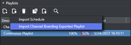

Export Playlist: Exports the playlist to a native Viz Channel Branding Client XML format. You can also export the Graphics and Data as part of the export.
Import a Channel Branding Exported Playlist
A playlist that has previously been exported from Viz Channel Branding Client, as an XML file can be imported back using the Import Channel Branding Exported Playlist menu item.
This will import the XML playlist to Viz Channel Branding without performing any mapping settings. Playlist data is set as it appears in the imported file.
Note: If the broadcast date specified already exists, the imported data will not replace the existing playlist. You must first delete the existing playlist.
Click the Import icon and select Import Channel Branding Exported Playlist.

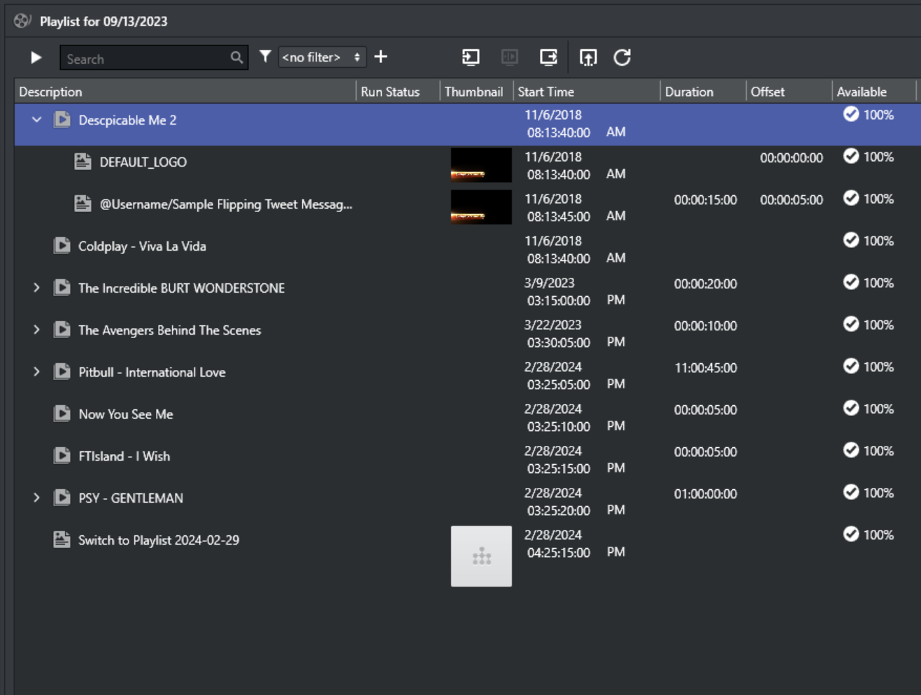

Playlist Columns
When the right pane displays the playlist, all events along with pages and actions scheduled together, are displayed.
To edit a playlist column
The layout and visibility of Playlist columns can be customized by arranging the columns.
Drag-and-drop to rearrange the columns. By right-clicking in a column header, you can further manage its appearance.
Note:
If there are any errors found in the playlist, the primary element causing the error displays in red. Hover-over the red No-entry icon of the error element for more information.
Secondary events that have been edited have a colored indicator on the left side of their edited row
Default columns
The following default columns are available, by default order:
Description: Shows a description of the element.
An arrowhead next to a description indicates that additional elements are group together with the event.
This may be a primary event with pages and/or actions scheduled for it as secondary events.Click the Arrowhead to expand and display secondary events.

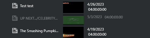

Thumbnail: Shows a snapshot/thumbnail of the template used in a secondary Event.
Start Time: Shows the element’s begin time, in a format based on local regional machine settings.
Offset: Offset of the secondary event relative to its primary event.
Duration: Duration of the element.
Available: Indicates if a video clip is available to your playout device.
Loaded: Shows the loaded status of pages on the Viz Engine program device channel.
Info I.H.: Displays timestamp and action-annotation for any events added or updated via Integrations Hub
Info P.S.: Displays timestamp indicating most recent moment the secondary event's Page Content Value was evaluated
Page Content Value: Shows a generated summary of the current values for Page Field's, regardless whether manually set or grabbed from dynamic sources via Promo Server.

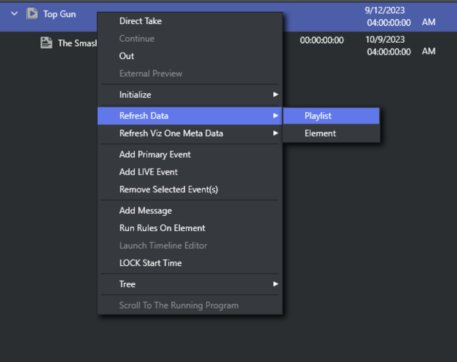

Playlist Context Menu
Right-clicking the playlist opens a context menu:
Direct Take: Takes the playlist element directly to air. If the element is available and/or loaded it will play immediately. If not, the element will be taken on air as soon as it becomes available.
Continue: Continues the animation of the graphics if the graphic has a Continue point.
Out: Takes the element off air (hard cut).
External Preview: Previews the element on your configured preview channel (see section Configuring Device Channels and Configuring Playout Devices).
Regenerate payload: Only for secondary events. Option to Forcefully regenerate the payload for the element.
Enable or Disable Element: Only for secondary events. Control enabling/disabling of secondary element. Elements in the playlist that are disabled are shown with a grayed-out style, as illustrated below:
Initialize (see section Playlist Toolbar).
Playlist: Initializes the entire playlist.
Element: Initializes the selected playlist element.
Refresh Data: Request a refresh of automatic page content or primary event Viz One metadata, as shown in the screenshot below:
Playlist: Clicking here iterates through the entire playlist and update all elements.
Element: Clicking here updates page data or Viz One metadata for the selected element of the playlist only.
Refresh Viz One Meta Data: forcefully re-read metadata from this event in Viz One, if applicable, and generate Event Meta Data from it.
Playlist: Do this for every event in the playlist.
Element: Do this for this single event.
Add Primary Event: Adds a primary event to the playlist.

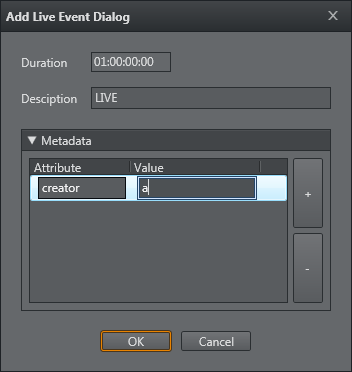

Add Live Event: Adds a live event.
Remove Selected Event(s): Removes one or several selected events from the playlist. This action cannot be undone.
Add Message: Add a Message Event (a playlist annotation that has no impact on playout) as information shared among other operators.
Run Rules On Element: Enabled for group and video primary events only. When selected, defined Rules will be run for the selected primary element only.
Launch Timeline Editor: Launches the Timeline Editor, see Working with Video Clips.
LOCK Start Time: Lock the event. Note that you can modify live or locked events in the Playlist column.
Tree:
Select All: Selects all events.
Select Inverse: Inverts your current selection, selecting all other elements.
Select None: Cancels all selections.
Expand All: Expands all primary events to show secondary events.
Collapse All: Collapses all primary events to hide secondary events.
Hide Empty Groups: Hides all empty groups.
Wrap Text: Wraps the text according to column width.
Font: Enables setting your own system font for the playlist.
Scroll To The Running Program: Scrolls the playlist view to show the current running primary element at the top.

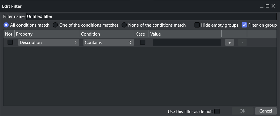

Adding a Playlist Filter
To add a new filter
Click the Plus icon.
The Edit filter window opens:
Enter a Filter name.
Select whether the filter should apply if:
All conditions match.
One of the conditions matches.
None of the conditions match.
Select whether or not to Filter on Group.
Continue to define your filter by adding conditions.
The list of events is filtered as you define your conditions, allowing you to verify that the filter is configured correctly.
Note: Filters are shared across all channels and between Playlist, Pages and Pilot Data Elements panels.
