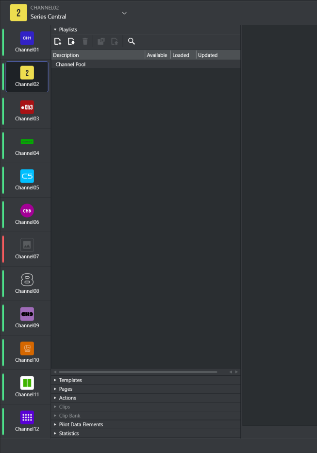

  1. Select your channel.
  2. Click the Playlists button.
    All existing playlists for the selected channel are displayed.
  3. Open your playlist.

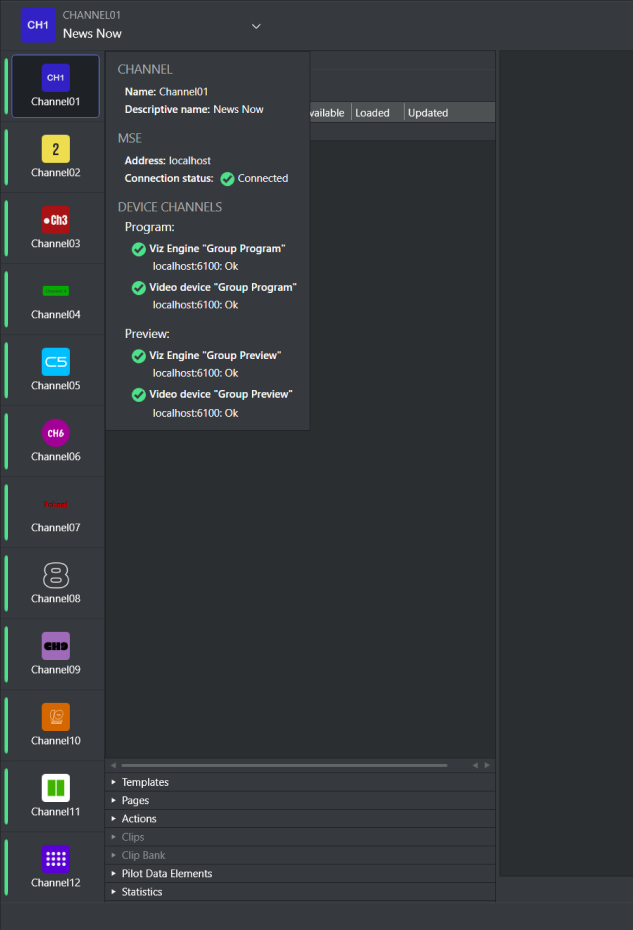

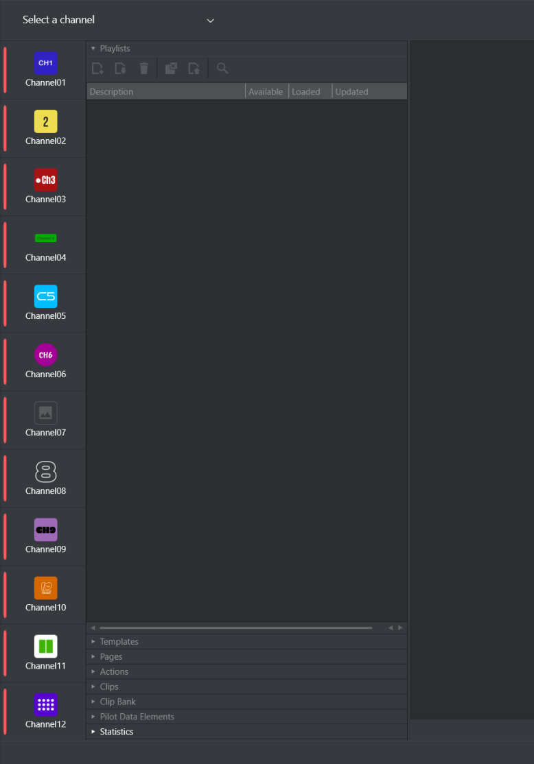

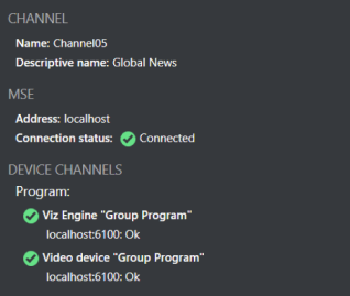

  • For monitoring purposes, Master Control Room (MCR) mode of the client application displays a sidebar listing all configured channels, with their status:
  • The sidebar allows selecting channels by clicking on the channel directly, and the client as well as the Channel selector dropdown are updated with the new selection:
  • Hovering-over a channel icon displays channel details and status:

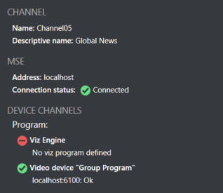

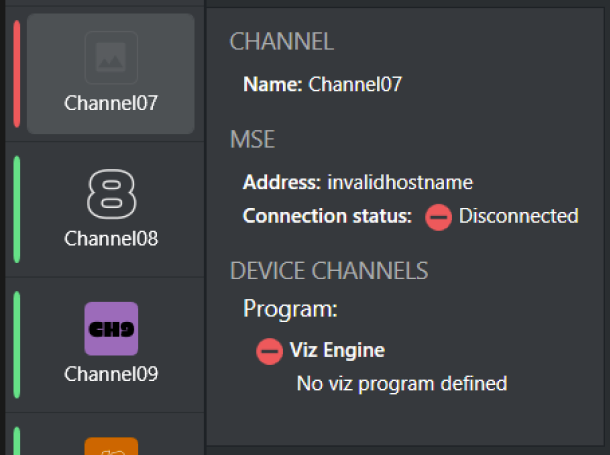

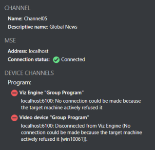

A channel can have one of three different status, depending on the Media Sequencer and channel playout devices presentation:
Type
Channel
Tooltip example
Success
Warning
Error
Info: Channel details like logo and descriptive name are fetched from the Media Sequencer configured in channels.ini. If this connection fails, these details are not displayed and an error status is presented.
